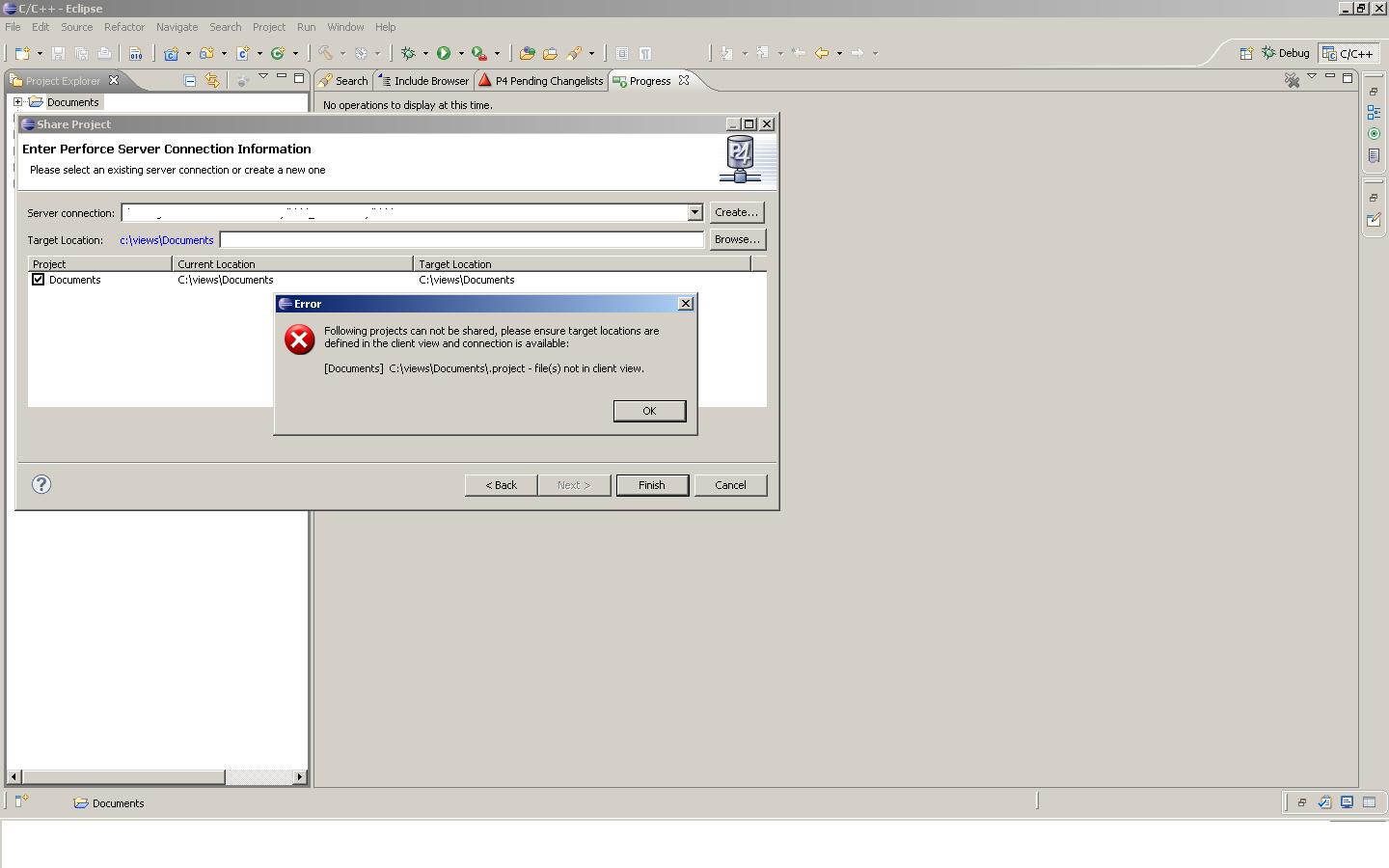

Re: importing a project in eclipse [message #674827 is a reply to message #661210] Sat, 28 May 2011 14:54 Go to previous messageGo to next message
Animesh mentions it above.
But here is the "secret"
Team -> Share Project -> Choose perforce.
Right click on your project and, towards the bottom of the menu, click Team -> Share Project.
Eclipse will then connect to Perforce and update the status of the source files (presuming you setup the Perforce client/depot correctly).
You will know if it works because the little file icons will update to indicate status (checked in, etc).
Also, if you start typing in a file, Eclipse will automatically check out the file.
It sounds silly but *nowhere* in the Eclipse Perforce plugin help file is this mentioned.
It sounds sillier but *nowhere* in the Perforce website's "how to" is this mentioned.
Particularly if you're coming from a MSVC dev environment, the above "Team->Share Project" is somewhat equivalent to MSVC's Right Click -> Source Control.

Re: importing a project in eclipse [message #824031 is a reply to message #675439] Mon, 19 March 2012 03:00 Go to previous message
I've had some trouble while importing projects with P4Eclipse. As far as i've searched, this is the most relevant thread that deals with importing projects.
I'm using Eclipse Helios with CDT and have recently integrated the P4Eclipse plugin.
The following are the steps that i've used to import a project into eclipse (as described in the video tutorial at the Perforce site).
1. Create New project with default location set to the location where i've synced the files from perforce.
2. Once the project is created, Right-click on project->Team->Share project.
3. In the 'Share project' dialogue box, choose Perforce and give the server configurations.
4. On hitting the Finish button, i get an error message 'Following projects can not be shared, please ensure target locations are defined in the client view and connection is available:
[<project_name>] <project_path>\.project - file(s) not in client view.'
Please help me resolve this issue. An image of the error message may be found in the attached file.
  • Attachment: eclipse.jpg
    (Size: 98.46KB, Downloaded 642 times)
