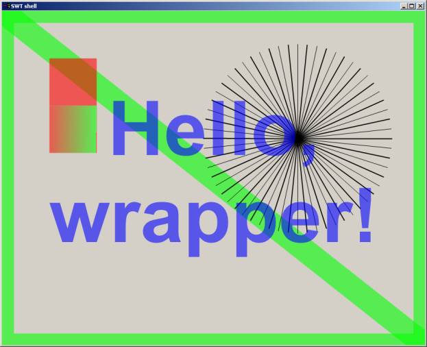

Re: Rotate figures, bezier, antialiasing etc. [message #58724 is a reply to message #58511] Tue, 28 January 2003 14:49 Go to previous messageGo to next message
Not only, but you are right, currently all affine transformations is a pain
(or you must use your own polyline for everything).
We are doing our Graphics class with primary goal to supprot antialiasing
(see picture attached). We can also extend this class with bezier curves and
polybezier and provide more support for affine transforms.
But currently we are working on Win32 version (using GDI+ wrapper), and to
make that in a right way we need enthusiasts from the other worlds...
as

  • Attachment: image002.jpg
    (Size: 36.97KB, Downloaded 150 times)

Re: Rotate figures, bezier, antialiasing etc. [message #59152 is a reply to message #58724] Tue, 28 January 2003 18:17 Go to previous messageGo to next message
Originally posted by: none.us.ibm.com
Cool, please try to get this into the SWT GC class. Some of the features
could be hints (not rotation, of course), which are ignored on other
platforms.

Re: Rotate figures, bezier, antialiasing etc. [message #59175 is a reply to message #59152] Tue, 28 January 2003 19:00 Go to previous messageGo to next message
I don't think that SWT people will like that idea... They already have heavy
classes and they don't need such functionality as we are here :)
Currently we will do that as a GEF patch (substituting SWTGraphics with our
own class if gdiplus.dll was detected).
Features like setSmoothingMode indeed will behave as hint and can be easely
added.
But we also like the idea to implement things like alpha blending and
gradient fills. That is absolutely another story, because in such case we
need to have Color (new one with additional constructor), Pen, Brush etc.
But i think that all of this can be very useful in modern 2d application.
OK, we will publish preliminary as soon as we will able to show the Logic
example with antialiasing :).
> pain
antialiasing
> and
to
> > Regards,
> > as

Re: Rotate figures, bezier, antialiasing etc. [message #59201 is a reply to message #58724] Tue, 28 January 2003 20:08 Go to previous messageGo to next message
