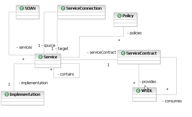

On a separate note can I get a clearer picture of the abstract service
concepts? From what I gathered on our call I have the following picture in
my mind. Is this correct? If not (and I assume it is not) what is missing
or what is wrong?
[Trieloff, Carl]
At a high level this modeling is good. one layer down the addition of
configuration, implementation and deployments artifacts needs to be added
and the ralationship to projects. should I do so for you? Need to work out
how to post UML to news group
Carl.
