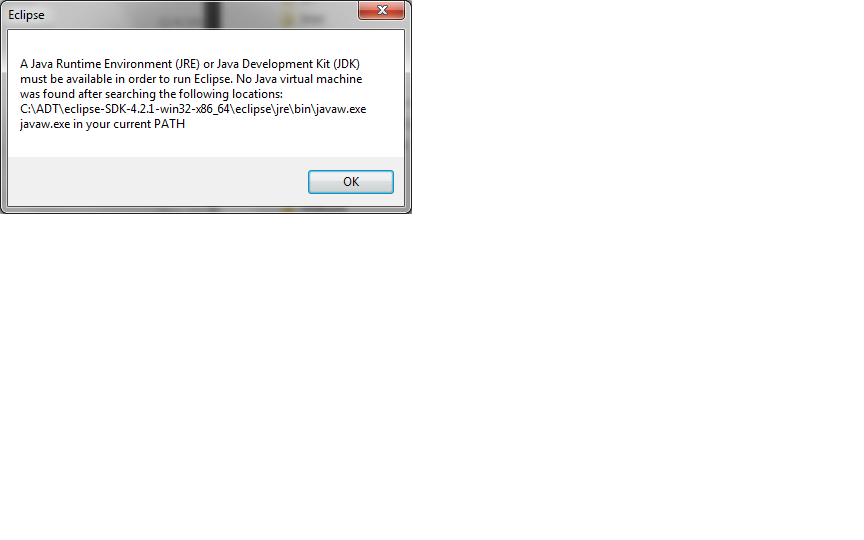

Nothing works for me from above.
Please help!
Got Windows 7 64-bit PC
1. Installed JAVA jre 64-bit into default:
C:\Program Files (x86)\Java\jre7
2. Trying to run Eclipse 64-bit from:
C:\ADT\eclipse-SDK-4.2.1-win32-x86_64\eclipse
Still get that error message above about incorrect PATH.
index.php/fa/12599/0/
Re: How to run Eclipse on Windows 7 64-bit [message #989186 is a reply to message #989182] Wed, 05 December 2012 00:06 Go to previous messageGo to next message
You don't have a 64 bit Java. The location you referenced would be a 32 bit java.
Once you have a Java version that matches your Eclipse download, the best way to get Eclipse running is to follow the instructions for specifying the JVM on the following page.
http://wiki.eclipse.org/Eclipse.ini
