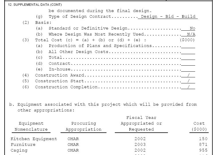

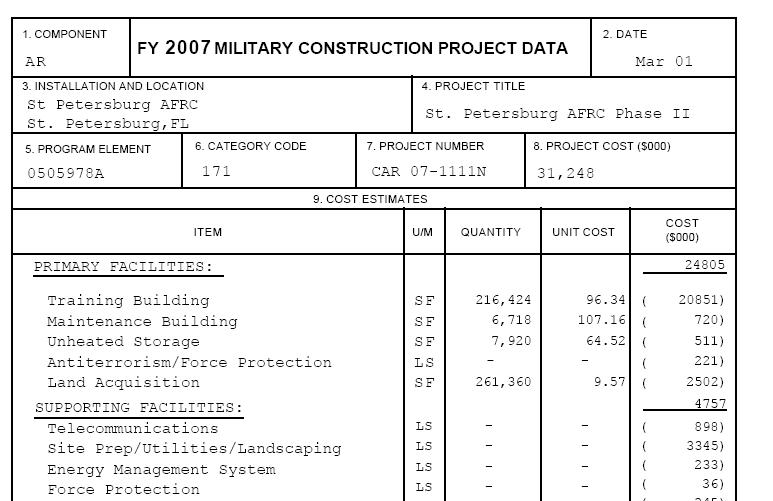

I just discovered BIRT today and have spent a few hours poking around. I'm
looking for a reporting tool that can handle complex government forms, such
as the one attached. (Sorry about the attachments being screen shots.
The real PDF is too big to be posted on the newserver.)
I'm assuming that - right now - the answer is no. But
do you think it might eventually work through the development of BIRT
extensions? (Another way to think about the question is whether or not
complex forms is a fit for where you think BIRT is heading.)

Originally posted by: qauck.msn.com
Chris,
What's the datasource type for your application? If that's just a
standard Master-Detail relation table, Birt can absolutely fullfill this
requirement. Feel free to check the "Group" feature for table and the
aggregation functoins in the expression builder.
HTH.

Re: good fit for BIRT? [message #42423 is a reply to message #42394] Fri, 03 June 2005 00:22 Go to previous messageGo to next message
Shawn,
Thanks for the tips. We're pulling from Oracle using the thin driver.
Chris

Hi Chris,
The following design files are created according to your attached
screenshots.
Cheers.
Nina

sourcedata[0][2] = 2002;
sourcedata[0][3] = 150.00;
sourcedata[1][0] = "Furniture";
sourcedata[1][1] = "OMAR";
sourcedata[1][2] = 2003;
sourcedata[1][3] = 871.00;
sourcedata[2][0] = "Caging";
sourcedata[2][1] = "OMAR";
sourcedata[2][2] = 2002;
sourcedata[2][3] = 955.00;]]></method>
<method name="fetch"><![CDATA[if (i < 3)
row["Equipment"] = sourcedata[i][0];
row["Procure"] = sourcedata[i][1];
row["Year"] = sourcedata[i][2];
row["Cost"] = sourcedata[i][3];
i ++;
return true;
else
return false;]]></method>
</script-data-set>
<script-data-set name="Data Set1">
<property name="dataSource">Data Source</property>
<list-property name="resultSet">
<structure>
<property name="position">1</property>
<property name="name">Type</property>
<property name="dataType">string</property>
</structure>
<structure>
<property name="position">2</property>
<property name="name">BasisStandard</property>
</structure>
<structure>
<property name="position">3</property>
<property name="name">RecentlyUsed</property>
</structure>
<structure>
<property name="position">4</property>
<property name="name">a</property>
</structure>
<structure>
<property name="position">5</property>
<property name="name">b</property>
</structure>
<structure>
<property name="position">6</property>
<property name="name">c</property>
</structure>
<structure>
<property name="position">7</property>
<property name="name">d</property>
</structure>
<structure>
<property name="position">8</property>
<property name="name">e</property>
</structure>
<structure>
<property name="position">9</property>
<property name="name">Award</property>
</structure>
<structure>
<property name="position">10</property>
<property name="name">Start</property>
</structure>
<structure>
<property name="position">11</property>
<property name="name">Completioin</property>
</structure>
</list-property>
<list-property name="columnHints">
<structure>
<property name="columnName">Type</property>
</structure>
<structure>
<property name="columnName">BasisStandard</property>
</structure>
<structure>
<property name="columnName">RecentlyUsed</property>
</structure>
<structure>
<property name="columnName">a</property>
</structure>
<structure>
<property name="columnName">b</property>
</structure>
<structure>
<property name="columnName">c</property>
</structure>
<structure>
<property name="columnName">d</property>
</structure>
<structure>
<property name="columnName">e</property>
</structure>
<structure>
<property name="columnName">Award</property>
</structure>
<structure>
<property name="columnName">Start</property>
</structure>
<structure>
<property name="columnName">Completioin</property>
</structure>
</list-property>
<method name="open"><![CDATA[i = 0;
sourcedata = new Array(11);
sourcedata[0] = "Design - Bid - Build";
sourcedata[1] = null;
sourcedata[2] = null;
sourcedata[3] = null;
sourcedata[4] = null;
sourcedata[5] = null;
sourcedata[6] = null;
sourcedata[7] = null;
sourcedata[8] = null;
sourcedata[9] = null;
sourcedata[10] = null;]]></method>
<method name="fetch"><![CDATA[if ( i < 1 ){
row["Type"] = sourcedata[0];
row["BasisStandard"] = sourcedata[1];
row["RecentlyUsed"] = sourcedata[2];
row["a"] = sourcedata[3];
row["b"] = sourcedata[4];
row["c"] = sourcedata[5];
row["d"]
Re: good fit for BIRT? [message #42607 is a reply to message #42502] Fri, 03 June 2005 07:29 Go to previous messageGo to next message
Hi Nina,
Thank you very much! I'm excited to try it out (still need to setup BIRT).
I've been reading the BIRT Report Object Model Overview and am growing more
and more impressed. Given what you've done below and a paragraph on page 12
regarding support for pixel-accuracy in reproducing gov't forms, I now
understand that BIRT will support such forms even though it is not its
primary focus. I was especially excited to discover that BIRT supports
RTF - you don't want to know what I had to do in order to "inject"
underlines into an already-generated PDF.
My next steps will be to experiment with BIRT starting with what you've
generously provided below. I'm also thinking that I'd like to contribute to
the project as both a user and developer. Can you tell me a little about
your role with BIRT?
thanks -
Chris
"Nina Li" <nli@actuate.com> wrote in message
news:b06cabc416e7a6f84973f76bee9ba592$1@www.eclipse.org...
> Hi Chris,
> screenshots.
> Cheers.
> Regards,
> Nina
> -------------------Form1---------------------------
> <?xml version="1.0" encoding="UTF-8"?>
> <!-- Written by Eclipse BIRT 1.0 -->
> <report xmlns=" http://www.eclipse.org/birt/2005/design" version="1">
> <property name="createdBy">Eclipse BIRT Designer Version 1.0.0 Build
> &lt;20050531-0733></property>
> <property name="units">in</property>
> <data-sources>
> <script-data-source name="Data Source"/>
> </data-sources>
> <data-sets>
> <script-data-set name="Data Set">
> <structure>
> <property name="name">CompanyName</property>
> </structure>
> <structure>
> <property name="name">Date</property>
> <property name="dataType">date-time</property>
> </structure>
> <structure>
> <property name="name">Installation</property>
> </structure>
> <structure>
> <property name="name">Location</property>
> </structure>
> <structure>
> <property name="name">Title</property>
> </structure>
> <structure>
> <property name="name">Element</property>
> </structure>
> <structure>
> <property name="name">CategoryCode</property>
> <property name="dataType">integer</property>
> </structure>
> <structure>
> <property name="name">ProjectNumber</property>
> </structure>
> </list-property>
> <structure>
> <property name="columnName">CompanyName</property>
> </structure>
> <structure>
> <property name="columnName">Date</property>
> </structure>
> <structure>
> <property name="columnName">Installation</property>
> </structure>
> <structure>
> <property name="columnName">Location</property>
> </structure>
> <structure>
> <property name="columnName">Title</property>
> </structure>
> <structure>
> <property name="columnName">Element</property>
> </structure>
> <structure>
> <property name="columnName">CategoryCode</property>
> </structure>
> <structure>
> <property name="columnName">ProjectNumber</property>
> </structure>
> </list-property>
> sourcedata = new Array(8);
> sourcedata[0] = "AR";
> sourcedata[1] = "3/1/2005";
> sourcedata[2] = "St Petersburg AFRC";
> sourcedata[3] = "St.Petersburg, FL";
> sourcedata[4] = "St. Petersburg AFRC Phase II";
> sourcedata[5] = "0505978A";
> sourcedata[6] = 171;
> sourcedata[7] = "CAR 07-111N";]]></method>
> row["CompanyName"] = sourcedata[0];
> row["Date"] = sourcedata[1];
> row["Installation"] = sourcedata[2];
> row["Location"] = sourcedata[3];
> row["Title"] = sourcedata[4];
> row["Element"] = sourcedata[5];
> row["CategoryCode"] = sourcedata[6];
> row["ProjectNumber"] = sourcedata[7];
> i++;
> return true;
> } else
> </script-data-set>
> <structure>
> <property name="name">FacilityLine</property>
> </structure>
> <structure>
> <property name="name">Facilities</property>
> </structure>
> <structure>
> <property name="name">U/M</property>
> </structure>
> <structure>
> <property name="name">Quantity</property>
> </structure>
> <structure>
> <property name="name">UnitCost</property>
> <property name="dataType">float</property>
> </structure>
> </list-property>
> <structure>
> <property name="columnName">FacilityLine</property>
> </structure>
> <structure>
> <property name="columnName">Facilities</property>
> </structure>
> <structure>
> <property name="columnName">U/M</property>
> </structure>
> <structure>
> <property name="columnName">Quantity</property>
> </structure>
> <structure>
> <property name="columnName">UnitCost</property>
> </structure>
> </list-property>
> sourcedata = new Array( new Array(5),
> new Array(5),
> new Array(5),
> new Array(5),
> new Array(5),
> new Array(5),
> new Array(5),
> new Array(5),
> new Array(5));
> sourcedata[0][0] = "PRIMARY FACILITIES";
> sourcedata[0][1] = "Training Building";
> sourcedata[0][2] = "SF";
> sourcedata[0][3] = 216424;
> sourcedata[0][4] = 96.34;
> sourcedata[1][0] = "PRIMARY FACILITIES";
> sourcedata[1][1] = "Maintenance Building";
> sourcedata[1][2] = "SF";
> sourcedata[1][3] = 6718;
> sourcedata[1][4] = 107.16;
> sourcedata[2][0] = "PRIMARY FACILITIES";
> sourcedata[2][1] = "Unheadted Storage";
> sourcedata[2][2] = "SF";
> sourcedata[2][3] = 7920;
> sourcedata[2][4] = 64.52;
> sourcedata[3][0] = "PRIMARY FACILITIES";
> sourcedata[3][1] = "Antiterrorism/Force Protection";
> sourcedata[3][2] = "LS";
> sourcedata[3][3] = 0;
> sourcedata[3][4] = 0;
> sourcedata[4][0] = "PRIMARY FACILITIES";
> sourcedata[4][1] = "Land Acquisition";
> sourcedata[4][2] = "SF";
> sourcedata[4][3] = 261360;
> sourcedata[4][4] = 9.57;
> sourcedata[5][0] = "SUPPORTING FACILITIES";
> sourcedata[5][1] = "Telecommunications";
> sourcedata[5][2] = "LS";
> sourcedata[5][3] = 0;
> sourcedata[5][4] = 0;
> sourcedata[6][0] = "SUPPORTING FACILITIES";
> sourcedata[6][1] = "Site Prep/Utilities/Landscaping";
> sourcedata[6][2] = "LS";
> sourcedata[6][3] = 0;
> sourcedata[6][4] = 0;
> sourcedata[7][0] = "SUPPORTING FACILITIES";
> sourcedata[7][1] = "Energy Management System";
> sourcedata[7][2] = "LS";
> sourcedata[7][3] = 0;
> sourcedata[7][4] = 0;
> sourcedata[8][0] = "SUPPORTING FACILITIES";
> sourcedata[8][1] = "Force Protection";
> sourcedata[8][2] = "LS";
> sourcedata[8][3] = 0;
> sourcedata[8][4] = 0;]]></method>
> <method name="fetch"><![CDATA[if (i < 8)
> row["FacilityLine"] = sourcedata[i][0];
> row["Facilities"] = sourcedata[i][1];
> row["U/M"] = sourcedata[i][2];
> row["Quantity"] = sourcedata[i][3];
> row["UnitCost"] = sourcedata[i][4];
> i ++;
> return true;
> else
> </script-data-set>
> </data-sets>
> <styles>
> <style name="Border">
> <property name="borderBottomStyle">solid</property>
> <property name="borderBottomWidth">thin</property>
> <property name="borderLeftStyle">solid</property>
> <property name="borderLeftWidth">thin</property>
> <property name="borderRightStyle">solid</property>
> <property name="borderRightWidth">thin</property>
> <property name="borderTopStyle">solid</property>
> <property name="borderTopWidth">thin</property>
> </style>
> <style name="Font">
> <property name="fontFamily">Arial</property>
> <property name="fontSize">smaller</property>
> <property name="fontWeight">normal</property>
> </style>
> <style name="Data">
> <property name="fontFamily">monospace</property>
> </style>
> <style name="Number">
> <property name="textAlign">right</property>
> <expression name="mapTestExpr">row["Quantity"]</expression>
> <list-property name="mapRules">
> <structure>
> <property name="operator">eq</property>
> <expression name="value1">0</expression>
> <text-property name="display">-</text-property>
> </structure>
> </list-property>
> </style>
> </styles>
> <page-setup>
> <simple-master-page name="Simple MasterPage">
> <property name="type">a4</property>
> <property name="leftMargin">0.34in</property>
> <property name="bottomMargin">1in</property>
> <property name="rightMargin">0.34in</property>
> <page-footer>
> <text>
> <property name="contentType">html</property>
> <text-property name="content"><![CDATA[<value-of>new
> Date()</value-of>]]></text-property>
> </text>
> </page-footer>
> </simple-master-page>
> </page-setup>
> <body>
> <grid>
> <property name="width">100%</property>
> <property name="dataSet">Data Set</property>
> <column>
> <property name="width">1.33in</property>
> </column>
> <column>
> <property name="width">4.97in</property>
> </column>
> <column>
> <property name="width">1.55in</property>
> </column>
> <row>
> <cell>
> <property name="style">Border</property>
> <label>
> <property name="style">Font</property>
> <property name="paddingTop">0.2cm</property>
> <property name="paddingLeft">0.2cm</property>
> <property name="paddingBottom">0.2cm</property>
> <property name="textAlign">left</property>
> <text-property name="text">1.
> COMPONENT</text-property>
> </label>
> <data>
> <property name="style">Data</property>
> <expression
> name="valueExpr">row["CompanyName"]</expression>
> </data>
> </cell>
> <cell>
> <label>
> <property name="fontSize">large</property>
> <property name="fontWeight">bold</property>
> <property name="textAlign">center</property>
> <text-property name="text">FY 2007 MILITARY
> CONSTRUCTION PROJECT DATA</text-property>
> </label>
> </cell>
> <cell>
> <label>
> <text-property name="text">2. DATE</text-property>
> </label>
> <data>
> <structure name="dateTimeFormat">
> <property name="category">Custom</property>
> <property name="pattern">MMM dd</property>
> </structure>
> <expression
> name="valueExpr">row["Date"]</expression>
> </data>
> </cell>
> </row>
> </grid>
> <grid>
> <column>
> <property name="width">4.3in</property>
> </column>
> <column>
> <property name="width">3.55in</property>
> </column>
> <row>
> <cell>
> <property name="borderBottomColor">#000000</property>
> <property name="borderBottomStyle">none</property>
> <property name="borderTopColor">#000000</property>
> <property name="borderTopStyle">none</property>
> <label>
> <text-property name="text">3. INSTALLATION AND
> LOCATION</text-property>
> </label>
> </cell>
> <cell>
> <label>
> <text-property name="text">4. PROJECT
> TITLE</text-property>
> </label>
> </cell>
> </row>
> <row>
> <cell>
> <text>
> <text-property
> name="content"><![CDATA[<VALUE-OF>row["Installation"]</VALUE-OF ><br>
> <VALUE-OF>row["Location"]</VALUE-OF>]]></text-property >
> </text>
> </cell>
> <cell>
> <property name="verticalAlign">middle</property>
> <data>
> <expression
> name="valueExpr">row["Title"]</expression>
> </data>
> </cell>
> </row>
> </grid>
> <grid>
> <column>
> <property name="width">1.9in</property>
> </column>
> <column>
> </column>
> <column>
> </column>
> <column>
> <property name="width">2.15in</property>
> </column>
> <row>
> <cell>
> <label>
> <text-property name="text">5. PROGRAM
> ELEMENT</text-property>
> </label>
> </cell>
> <cell>
> <label>
> <text-property name="text">6. CATEGORY
> CODE</text-property>
> </label>
> </cell>
> <cell>
> <label>
> <text-property name="text">7. PROJECT
> NUMBER</text-property>
> </label>
> </cell>
> <cell>
> <label>
> <text-property name="text">8. PROJECT COST
> ($000)</text-property>
> </label>
> </cell>
> </row>
> <row>
> <cell>
> <data>
> <expression
> name="valueExpr">row["Element"]</expression>
> </data>
> </cell>
> <cell>
> <data>
> <expression
> name="valueExpr">row["CategoryCode"]</expression>
> </data>
> </cell>
> <cell>
> <data>
> <expression
> name="valueExpr">row["ProjectNumber"]</expression>
> </data>
> </cell>
> <cell>
> </cell>
> </row>
> </grid>
> <table>
> <property name="dataSet">Data Set1</property>
> <column>
> <property name="width">4in</property>
> </column>
> <column>
> <property name="width">0.5in</property>
> </column>
> <column>
> <property name="width">1in</property>
> </column>
> <column>
> <property name="width">0.95in</property>
> </column>
> <column>
> <property name="width">1.4in</property>
> </column>
> <header>
> <row>
> <cell>
> <property name="colSpan">5</property>
> <property name="rowSpan">1</property>
> <label>
> <property name="paddingTop">0.1cm</property>
> <text-property name="text">9. COST
> ESTIMATES</text-property>
> </label>
> </cell>
> </row>
> <row>
> <cell>
> <property name="colSpan">1</property>
> <label>
> <text-property
name="text">ITEM</text-property>
> </label>
> </cell>
> <cell>
> <label>
> <text-property name="text">U/M</text-property>
> </label>
> </cell>
> <cell>
> <label>
> <text-property
> name="text">QUANTITY</text-property>
> </label>
> </cell>
> <cell>
> <label>
> <text-property name="text">UNIT
> COST</text-property>
> </label>
> </cell>
> <cell>
> <text>
> <property name="contentType">plain</property>
> <text-property name="content"><![CDATA[COST
> ($000)]]></text-property>
> </text>
> </cell>
> </row>
> </header>
> <group>
> <property name="groupName">FacilityLine</property>
> <property name="interval">none</property>
> <property name="sortDirection">asc</property>
> <expression
name="keyExpr">row["FacilityLine"]</expression>
> <header>
> <row>
> <cell>
> <property
> name="borderLeftColor">#000000</property>
> <property
> <property
> <property
> name="borderRightColor">#000000</property>
> <property
> <property
> <property name="paddingLeft">0.4cm</property>
> <property
> <data>
> <property
> name="textUnderline">underline</property>
> <expression
> name="valueExpr">row["FacilityLine"]</expression>
> </data>
> </cell>
> <cell>
> <property
> <property
> <property
> </cell>
> <cell>
> <property
> <property
> <property
> </cell>
> <cell>
> <property
> <property
> <property
> </cell>
> <cell>
> <property
> <property
> <property
> <data>
> <property
> <structure name="numberFormat">
> <property
> <property
name="pattern">###</property>
> </structure>
> <property
> <expression
name="valueExpr">Total.sum(row["Quantity"]*row["UnitCost "]/1000)</expression
> </data>
> </cell>
> </row>
> </header>
> <footer>
> <row>
> <cell/>
> <cell/>
> <cell/>
> <cell/>
> <cell/>
> </row>
> </footer>
> </group>
> sourcedata = new Array( new Array(4),
> new Array(4),
> new Array(4));
> sourcedata[0][0] = "Kitchen Equipment";
> sourcedata[0][1] = "OMAR";
> i ++;
> return true;
> else

Re: good fit for BIRT? [message #42760 is a reply to message #42607] Fri, 03 June 2005 11:54 Go to previous message
Chris,
As Nina has demonstrated, BIRT can definitely be used to create the type of
forms you're interested in doing.
However, in BIRT 1.0 the output types are limited to HTML and PDF. Also,
because we are using Apache FOP to do PDF generation, we inherit some
limitations in that area from FOP. You may want to check out the limitations
section of the FAQ to get a better sense for those:
http://www.eclipse.org/birt/index.php?page=faq/limitations.h tml
The ROM documentation you read describes the full capability set that is
ultimately planned for BIRT. The 1.0 release provides a subset of those
capabilities, and the requirements document you found for 1.0 is the best
source for a high level description of the capabilities specific to 1.0.
By the way, Nina and I are both involved with the project as BIRT
committers.
regards,
Mark
