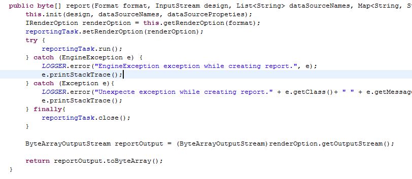

Re: setOutputStream closes the stream after processing. [message #1220553 is a reply to message #362712] Thu, 12 December 2013 09:23 Go to previous messageGo to next message
Hallo everybody,
I have the same problem, anyone has idee,
please help us
IRenderOption renderOption = this.getRenderOption(format);
reportingTask.setRenderOption(renderOption);
ByteArrayOutputStream reportOutput= (ByteArrayOutputStream)renderOption.getOutputStream();
when I send 2 Requestt (Parallel) I get only one Response, the other reponse can not process it, because the outputstream is already in use....... Crying or Very Sad Crying or Very Sad
private static final Logger LOGGER = Logger.getLogger(DefaultReportService.class.getName());
IRunAndRenderTask reportingTask = null;
public byte[] report(Format format, InputStream design, List<String> dataSourceNames, Map<String, String>dataSourcePropeties) {
this.init(design, dataSourceNames, dataSourcePropeties);
try {
reportingTask.run();
} catch (EngineException e) {
LOGGER.error("EngineException exception while creating report.", e);
e.printStackTrace();
} catch (Exception e){
LOGGER.error("Unexpecte exception while creating report." + e.getClass()+ " " + e.getMessage(), e);
} finally{
reportingTask.close();
ByteArrayOutputStream reportOutput = (ByteArrayOutputStream)renderOption.getOutputStream();
return reportOutput.toByteArray();
  • Attachment: delete.JPG
    (Size: 55.08KB, Downloaded 210 times)
