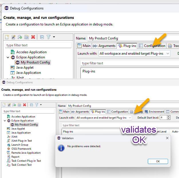

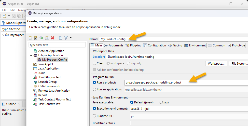

This is where I saw the issue. I need to run my Eclipse as a "product" so I created a Runtime configuration like this.
index.php/fa/45345/0/
I validated all plugins and see that there are no errors or missing plugins.
index.php/fa/45348/0/
I click Run and Eclipse runs using the product configuration.

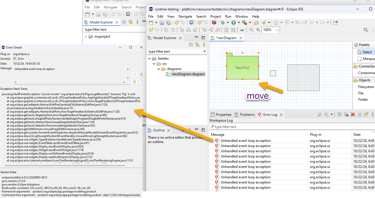

Then I ran the same test as above, I created a project and diagram. I started to move the shapes and I get the 'Unhandled event loop' error in the logs.
index.php/fa/45351/0/
Anyone else saw this issue?
Or does anyone know if I am missing something or how to fix this?

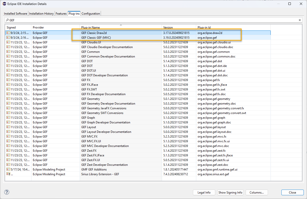

Here's what I did. I downloaded the latest base Eclipse Modeling Package. I'm using Java 21 and installed Graphiti 0.19.2 from the update site.
Then I created a Runtime Configuration similar to above (org.eclipse.epp.package.modeling.product) to run a separate Eclipse Instance.
These are the GEF versions installed in my Eclipse.
index.php/fa/45389/0/
I see the error when I resize or move a shape (as the above). But only happens on a seprate instance when I run using my Runtime Configuration. Something is not loaded properly?
