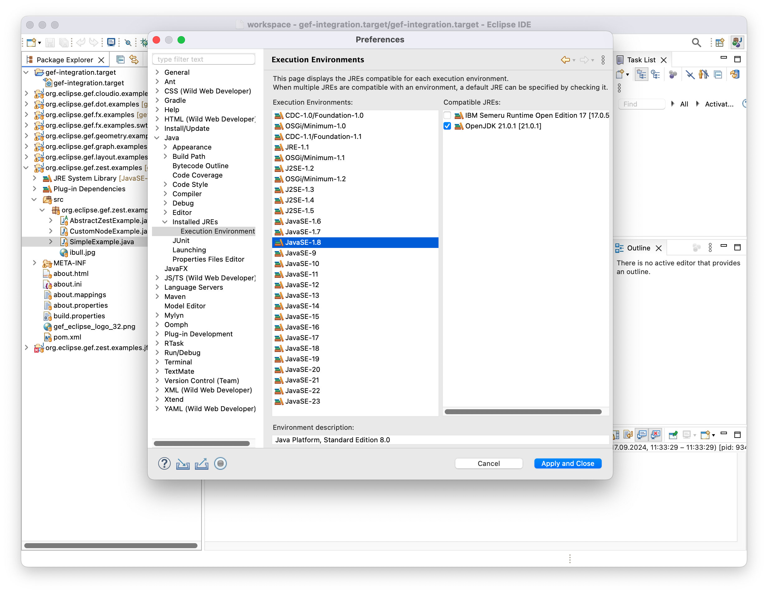

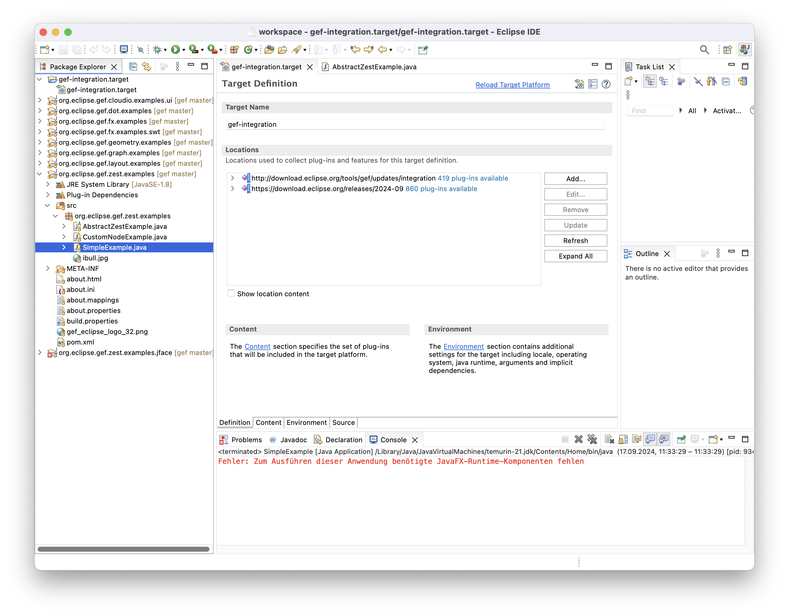

I follow the explanations of https://github.com/eclipse/gef?tab=readme-ov-file and want to try out the examples as described in the "Run the examples" section. I did all the setup - I think - in the right way as described. But when i try out the example in org.eclipse.gef.zest.examples SimpleExample I get the error message
Fehler: Zum Ausführen dieser Anwendung benötigte JavaFX-Runtime-Komponenten fehlen
I add some screenshots to show my configuration
I appreciate any hint, thank you

I first tried your second solution and got (see screenshot).
The first one I would like to skip, because I use already OpenJDK 21 and OpenFX 21 and Eclipse 4.33.0, but it seems I have not really an option?
