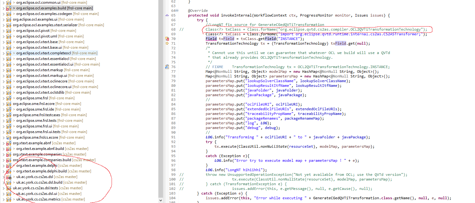

I am trying to install CS2AS DSL of Adolfo Sanchez-Barbudo Herrera. Has anyone tried it? I am having problem with org.eclipse.qvtd.cs2as.compiler.OCL2QVTiTransformationTechnology.
Please help me !

The last commit by Adolfo Sanchez-Barbudo Herrera was 8 years ago. Since then I have maintained the code to track API evolution and keep the tests working, but I may well have overlooked something.
The intent of CS2AS was never fulfilled, so it has never taken its place as part of the OCL build chain.
IIRC, in my Reflections on OCL 2 paper [1], I concluded that I should never have attempted to provide an implementation so close to the unprototyped specification since this mandates a CS2AS stage. Rather a revision of CS and AS could have provided much better compatibility and so avoided a difficult CS2AS.
If you want to use CS2AS, I suggest building an Eclipse installation corresponding to Adolfo's final commit so that you can reproduce examples from the thesis [2] that you found in [3]. The functional code is in the OCL [4] and QVTd [5] GIT repos. For [4] and [5] I provide the project PMI page linked to the repository since the Eclipse Foundation may soon move these repos to github.
Once you are happy with the 'old' way you may see whether it ports to the prevailing GIT state.
(The underlying Complete OCL technology for CS2AS exploiting shadow constructors was necessary since QVTr was not nearly ready. QVTr does now work for many examples, but my WIP attempts to use it for a transformation such as Ecore2Pivot reveal the need for additional language richness to handle a missing root model element on one side - oops Ecore's Resource is not a model element.)
