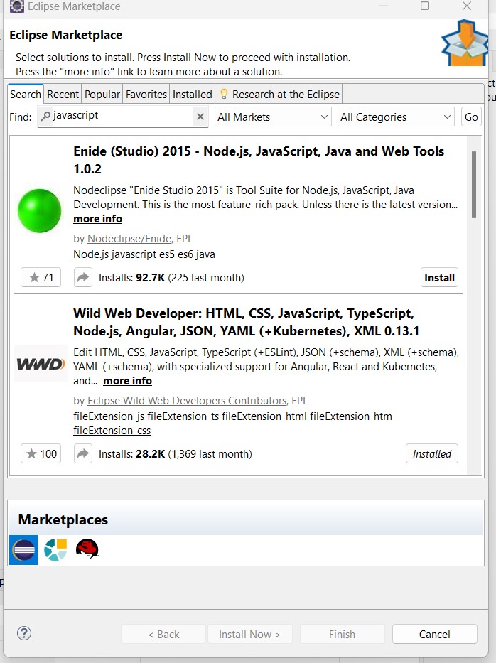

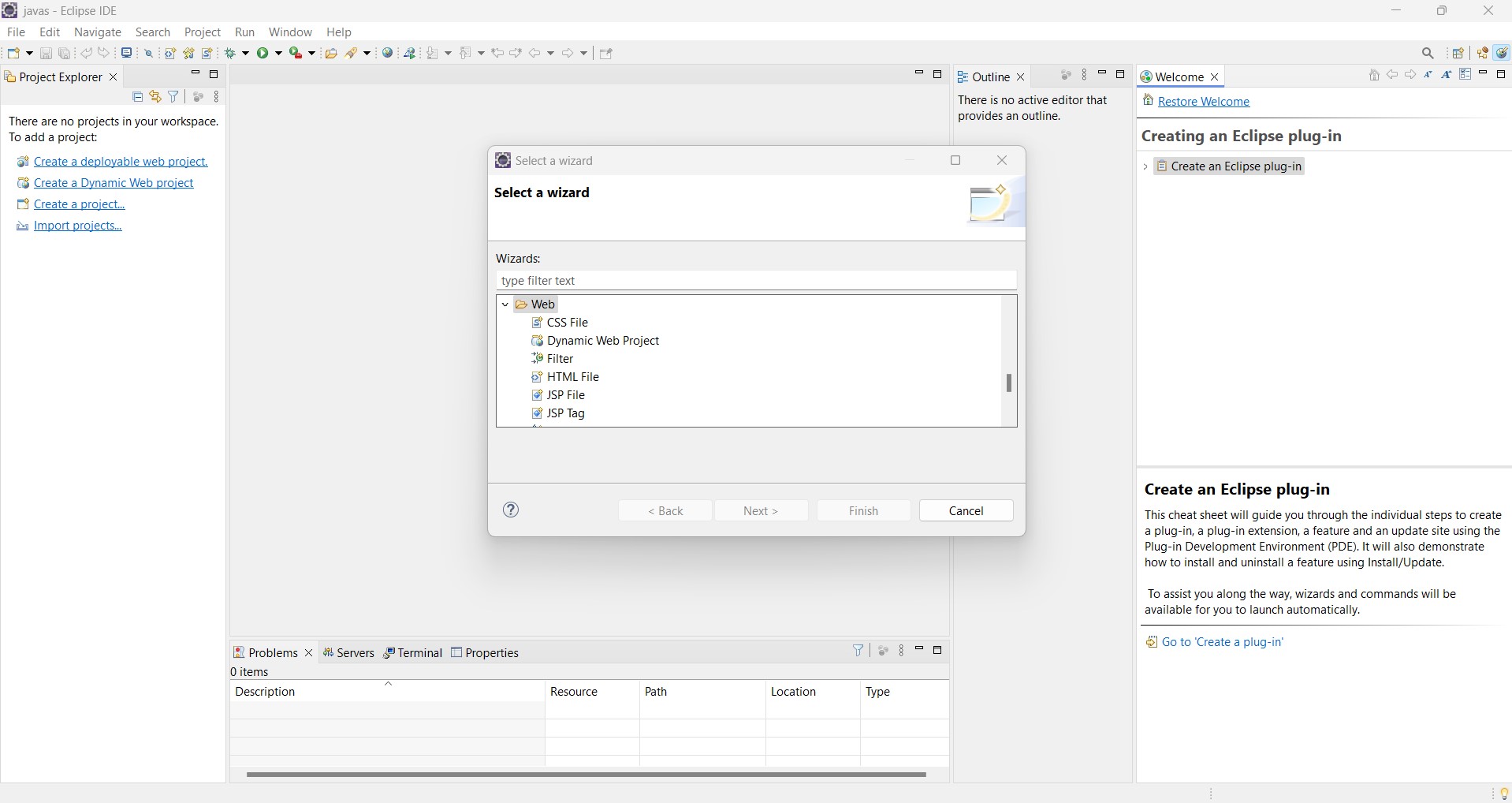

Using the 2nd as an example I do not see the web:javascript selection that is mentioned (see 1st attachment) which is why I was thinking my install was not correct. The "help:about" only lists the information that I cited. I do not see anything about plugins etc so that is the best that I can provide.
Based upon your post I checked https://projects.eclipse.org/projects/tools.wildwebdeveloper
It is not clear if this is the particular plugin that is needed or if there are other choices (I am trying to use "common" methods)--clicking on the latest version does not lead to an install or install instructions.
I see a "market place" entry in help: and I see "installed" for one of the options (see 2nd attachment) but this did not lead to the results above.

The Vogella tutorial is built around JSDT, which does offer a new JS file wizard, but was a different solution and might not be installed depending
on what features you picked. Wild Web Developer has different preference pages of its own, but no wizards that I know of.
