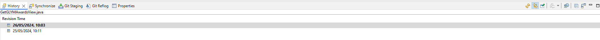

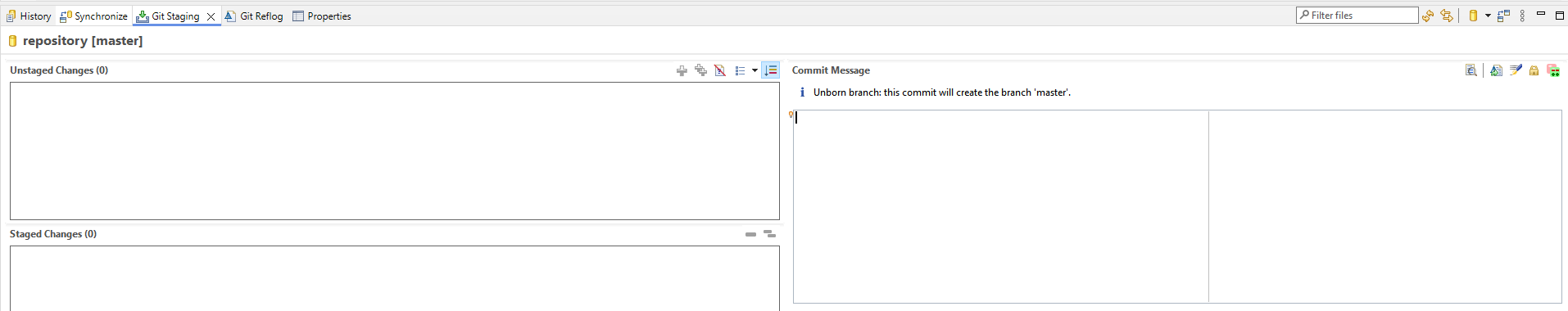

I have down loaded a new version (2024-03 (4.31.0)) and imported my old project from some years ago (2022). I now want to push changes to my GitHub repository. When I go into Window --> Perspective --> Open Perspective --> Other --> Git and open the History tab my revisions are present. However, when I open the 'Git Staging' tab there are not any changes to push to my BitBucket repository. I have attached images.

It seems to me your History view is showing the local history, not Git history and the Git Staging view talks about an unborn branch so you have no commits. I suspect your files are not physically located in the folder of the git clone but likely just in the workspace.
What's on the containing projects's context menu under Team -> ? If it has "Share Project..." then you haven't placed the project within a Git repository's folder.
Re: Git Staging not populating with changes (they are History) [message #1866369 is a reply to message #1866333] Tue, 28 May 2024 03:28 Go to previous messageGo to next message
Hi Ed,

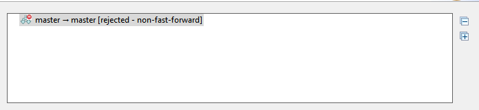

That did it. I now have my changes in the Git Staging area. However, when I commit and push I get the error "master --> master [rejected - non-fast-forward]. Please see attached. And my changes are not in the Git Staging any more.

I did a pull and then another 'Commit and Push' and it now seems to work.
