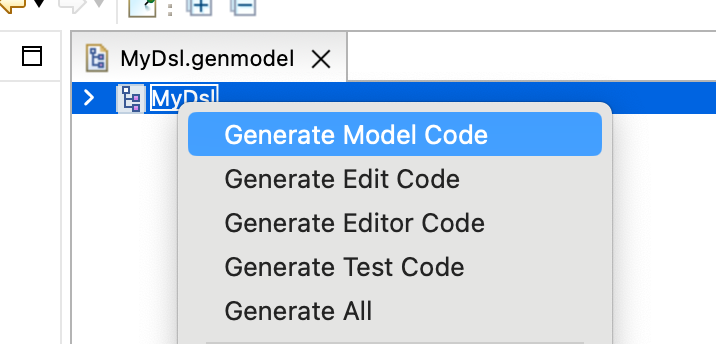

Re: Custom Validator on Xtext Project From Existing Ecore Model [message #1865478 is a reply to message #1865457] Sat, 04 May 2024 01:40 Go to previous messageGo to next message
no you open the genmodel file. select the root in the editor. and select "Generate Model Code"
this will produce the java classes for the ecore of the genmodel is for

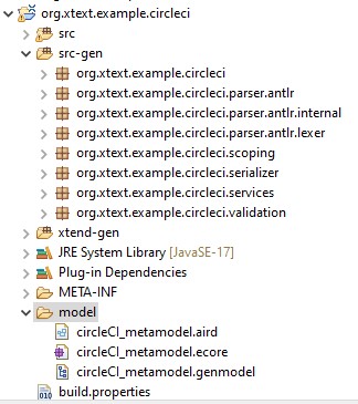

I don't think I expressed myself correctly. I have a modelling project (CircleCI_metamodel) that has the src-gen folder with the packages I mentioned. The problem is that I created an Xtext project (org.xtext.example.circleci) from this ecore model and Xtext doesn't generate these packages when I run the .mwe2 file. I want to have these packages in the Xtext project to perform customised validations. I copied the .genmodel file from my modelling project to the Xtext project, selected the root and generated model code but it didn't create the packages in the Xtext project. I think it just updated the code generated in my modelling project.

Re: Custom Validator on Xtext Project From Existing Ecore Model [message #1865502 is a reply to message #1865499] Sat, 04 May 2024 08:09 Go to previous messageGo to next message
why do you expect the xtext project to generate
simply add your CircleCI_metamodel project to the required bundles in the manifest of
and the classes will be available
no need to copy genmodel and ecore.

the literals interface wont be generated if the metamodel is "too big". also if the metamodel is derived/generated by Xtext
then you can Use MyPackage.eINSTANCE.getMyMetaClass_myFeature() instead
