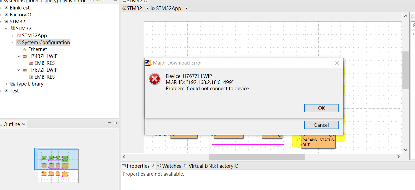

Thank you for guidance. Recently I'm learning modular IO infra and implemented simple led blinking on stm32 board via IO. I have connected my computer to both STM32F767 and STM32F743 via NETGEAR Plus Switch, however, when I deploy the application on both STM32, most of the time, only one resource can be successfully deployed, and the other one reports an error "Could not connect to device" or "Query resources failed for device" . Sometimes there is no error and both work, but only one can be monitored, as if the port is occupied. I would like to know what's going on? Attached is a picture of the problem.

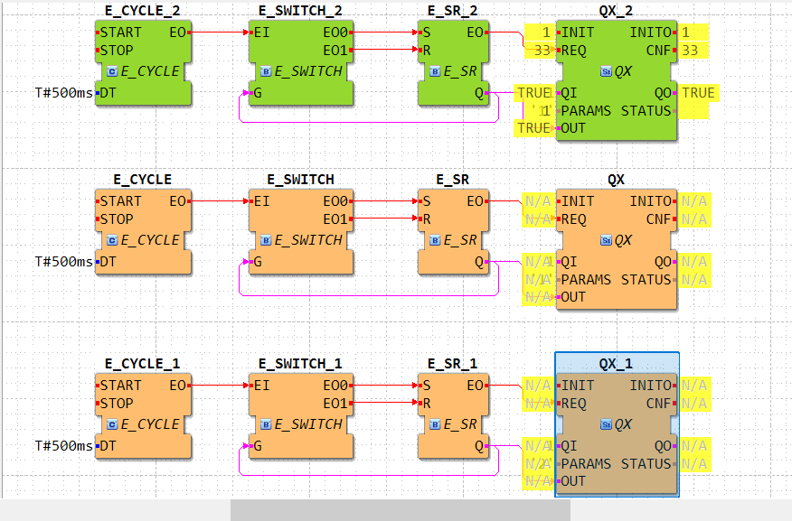

Can you please also post a screenshot of your system configuration?
Re: How to get 4diac to support EtherCAT [message #1864065 is a reply to message #1864064] Thu, 14 March 2024 03:58 Go to previous messageGo to next message
OK!
Re: How to get 4diac to support EtherCAT [message #1864067 is a reply to message #1864065] Thu, 14 March 2024 04:01 Go to previous messageGo to next message
Thx. That helped to clarify a doubt I have. Could not connect to device means that the port 61499 is not available or 4diac IDE could not establish a connection to your device. There are several reasons for this: the most simplest 4diac FORTE is not running. Could it be that your 4diac FORTE instance is crashing?
Other reasons is that a previous connection is not cleanly closed. Are you useing the latest development version from github? There where some change by Franz to improve connection management.

Thanks for your answer. My forte instance sure crashed once or twice for unknown reasons. And the device works fine in another computer, the problem could be in the connection. The version I'm using is forte 2.0.1 from the 4diac website.
Re: How to get 4diac to support EtherCAT [message #1864071 is a reply to message #1864069] Thu, 14 March 2024 04:18 Go to previous messageGo to next message
Unreliable connections are unfortunately a real problem that we currently have a hard time to fix. However we just merged yesterday the first commits that will allow to use OPC UA for the communication between 4diac IDE and 4diac FORTE. With that we hope that the situation will improve. Deployment will definitely be faster.
