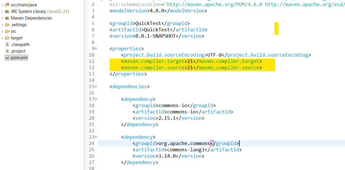

If you're using Maven, try updating the Maven project (IIRC the default keybind is Alt+F5) after changing the Java versions in your POM. This should update the compiler settings.
Re: Reset Java Version - Switch from 1.8 to 21 [message #1863737 is a reply to message #1863736] Fri, 23 February 2024 14:13 Go to previous messageGo to next message
Erik Brangs wrote on Fri, 23 February 2024 18:29
Like that:
index.php/fa/44001/0/

Ok, that worked. Doesn't everyone use Maven? Not sure why I had to do that.
