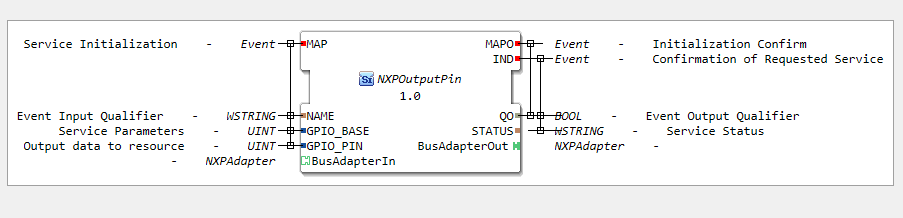

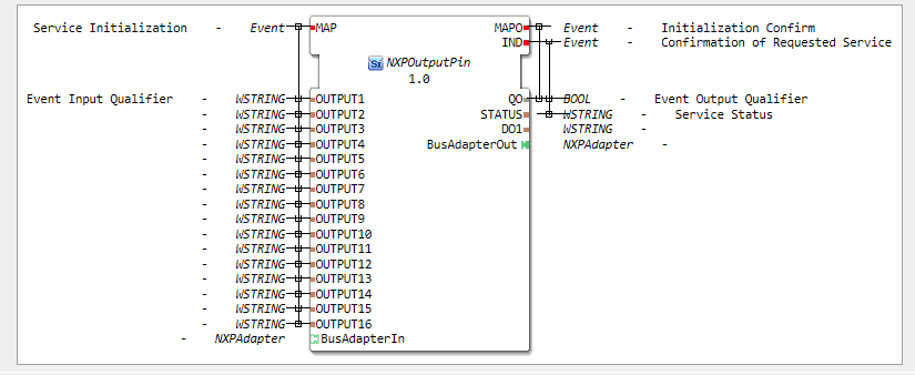

Hello, i want to make a block with multiples outputs to use with my RT1060. But my customer want to make the definition of the pins dinamically. To do that, i think in a way, write in the OUTPUT the string "QX[1,1]". QX is the output block, the numbers in the brackets is the GPIO_BASE and the GPIO_PIN.

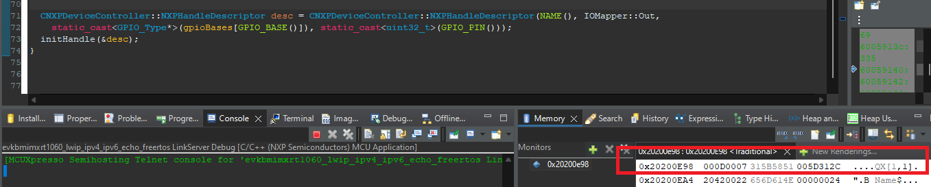

In the software, i can find the handle of the block and this string. What i need to do is change the name of the handle to "QX". That's a way to do that?. Separate the value of the GPIO_BASE and GPIO_PIN i geti it.
In the first image i have the block.
In the second image i find the place where the string is save, but i don't know how can i change the string.

I'm not sure if I understand your question fully. But normally you need to create one handle per pin. and map each pin to one of your strings of your NXP block. The rest should be done by our framework. you can look at the Wago module how there it is done.

Yes Alois, that way worked. I use the block in the image and the definition of this block is dinamically. But the problem is my customer want a block with multiple outputs and each output must be dinamically selected. But i don't know how to define the GPIO_BASE and GPIO_PIN dinamically. I think this way.
