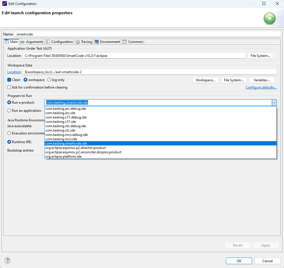

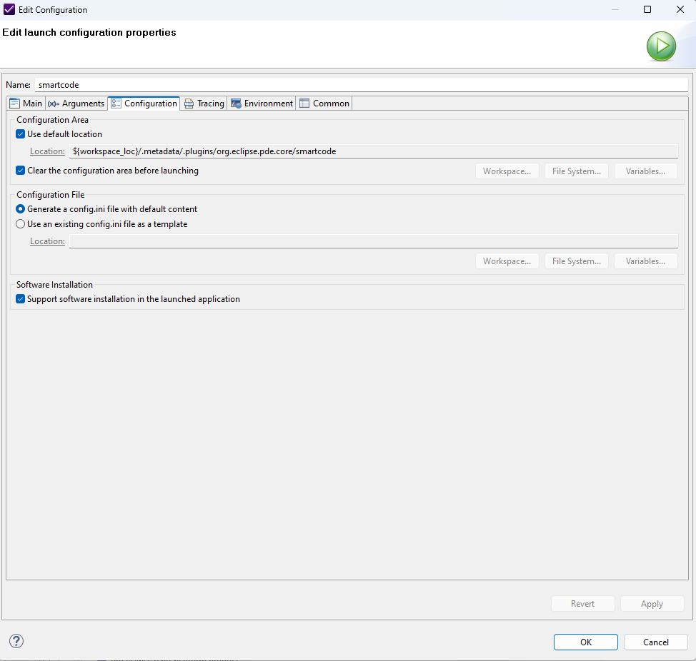

I am trying to run tests written in RCPTT with test runner. To start AUT I needed to adjust 2 of the AUT configurations which I don't know how to adjust with test runner.
  1. I need to select Program to run - Run a product: com.tasking.smartcode.ide
  2. And select Software Installation - Support software installation in the launched application
My question is how to configure those two settings in test runner batch script for Windows.

Re: RCPTT Test runner AUT advanced configuration [message #1862279 is a reply to message #1861888] Wed, 22 November 2023 02:15 Go to previous messageGo to next message
Solution to 'How to select Program to run - Run a product' is: VM argument -Declipse.product=com.tasking.smartcode.ide
I still do not know 'How to enable Support software installation in the launched application with test_runner'...
Re: RCPTT Test runner AUT advanced configuration [message #1863349 is a reply to message #1862279] Mon, 29 January 2024 01:52 Go to previous message
RCPTT runner argument '-enableSoftwareInstallation' and
maven plugin input parameter <enableSoftwareInstallation>true<enableSoftwareInstallation>
has been added to enable 'Support software installation in the launched application'.
https://github.com/eclipse/org.eclipse.rcptt/pull/34
