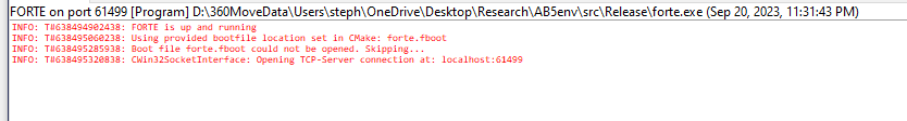

I'm currently building my own function blocks, and according to the tutorial guidelines, I exported my function blocks, wrote a Cmake file, and then used Cmake GUI to compile my function blocks into 4diac-FORTE, generated a project and built it. During all of this, no error occurred.
However, when I try to run my FORTE locally, it comes with the following error message:
INFO: T#638494902438: FORTE is up and running
INFO: T#638495060238: Using provided bootfile location set in CMake: forte.fboot
INFO: T#638495285938: Boot file forte.fboot could not be opened. Skipping...
INFO: T#638495320838: CWin32SocketInterface: Opening TCP-Server connection at: localhost:61499
I don't know about the forte. fboot file, I thought this file should be auto-generated when I build my FORTE environment?

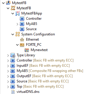

Actually, I have created an application and mapped my FBS to my system configuration.
Here is my screenshot.

And then I have placed the forte.fboot file into my new forte environment's CMakefile. But when I run my 4diac-Forte locally in port 61499, it gives me the same error message ( forte.fboot cannot be opened... something like this)
Just wondering, is this because I put my forte.fboot into the wrong folder?
Re: 4diac FB testing [message #1862436 is a reply to message #1861240] Tue, 05 December 2023 05:39 Go to previous message
Sorry for the late reply. I somehow missed your message. The boot file needs to be in the same directory where 4diac FORTE is executed in. This may not be the directory where your 4diac FORTE is located.
