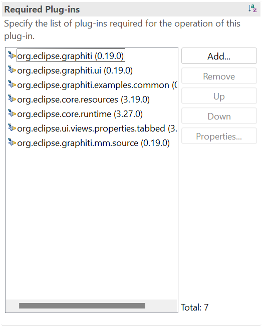

I apologize for my complete ignorance, but how can I run the complete example project? I believe that I have downloaded the Graphiti SDK but I don't have the example project when I click on File->New->Example.
Also, I'm pretty sure that I have all of the plugin dependencies defined properly, could you have a look at the attached screenshot? I still have the same issues that I metioned in the previous post.

Hi Leonard,
from the screenshot this looks ok.
The File -> New -> Example will just allow you to create a Graphiti diagram using the example, but cannot be used to have a look at the project itself.
The easiest way to get the project when you have the Graphiti SDK installed in your IDE is probably to do Import -> Plug-in Development-> Plug-ins and Fragments
On the next page of the wizard select "Projects with source folders" under "Import as" (leave the rest as default, then on the next page bring "org.eclipse.graphiti.examples.tutorial" into the right column and press finish. You should then get the complete project with sources in your workspace.
-Michael
