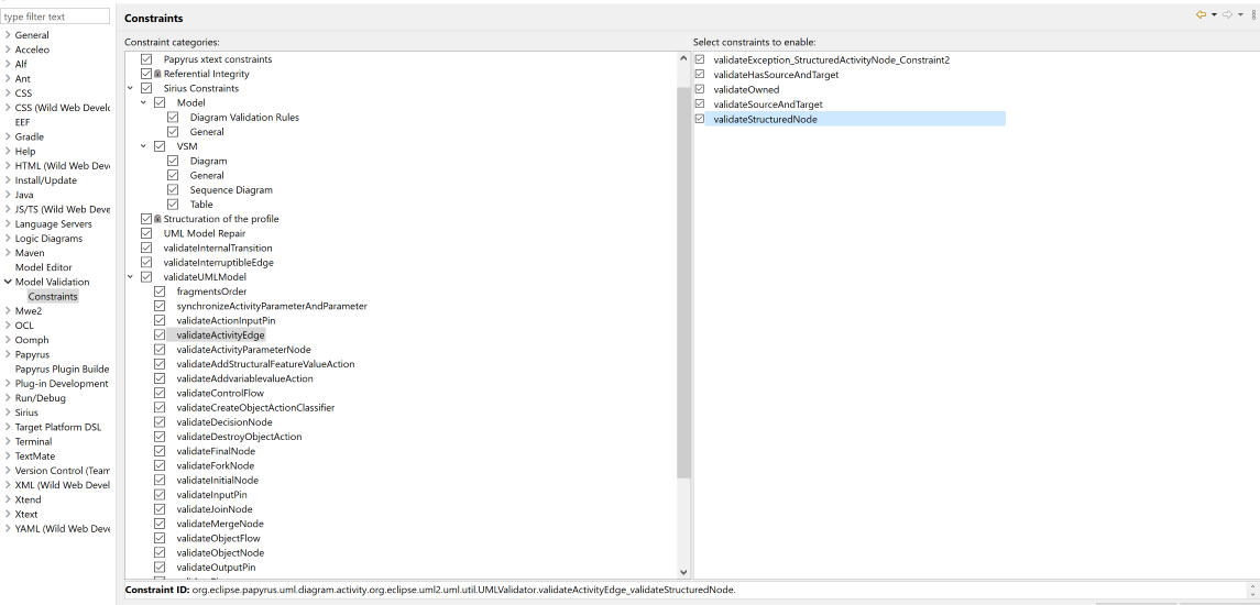

Yes, you can open the file with the Ecore editor (or UML editor) and in the contextual menu you will find a Validate action. This action will validate the model using rules at emf level and and uml level if the UML contraints haven been implemented by UML2 or Papyrus.
Here a snapshot of the preferences for EMF validation:
index.php/fa/43458/0/
