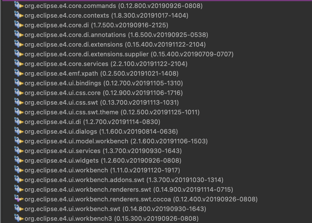

I have attached an overview of the e4 section of the plugins folder.
