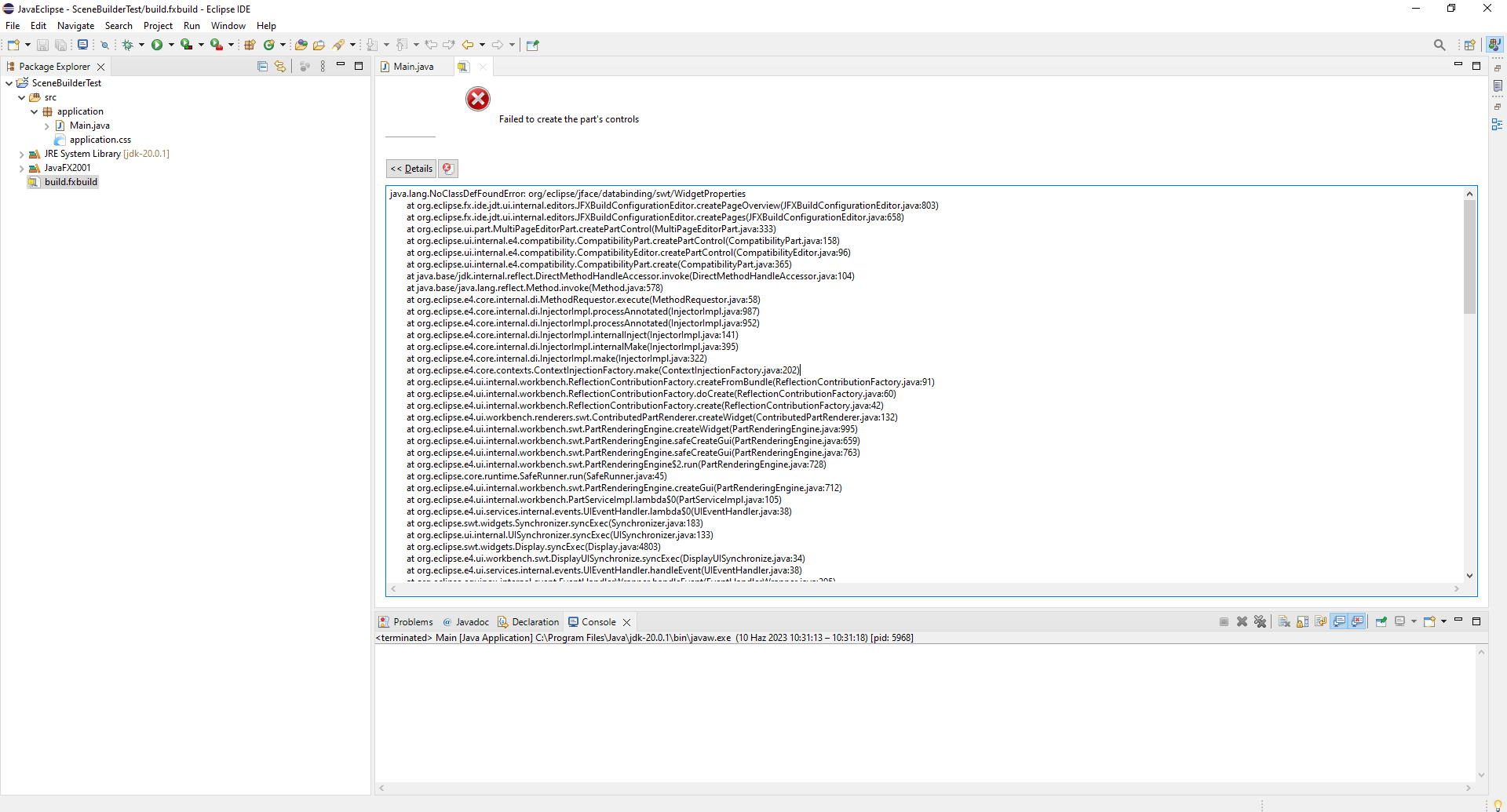

Basically, I cover the JavaFX learning process with youtube tutorials. I'm having issues when it gets to this stage:
After right-clicking on "Package name in any name" > New > Other > JavaFX folder > New FXML Document it doesn't generate anything. There is no error in the "Problem" field, which is the bottom tab. So after a long time I clicked on the build.fxbuild file in the left workspace out of pure curiosity. I saw many mistakes written in front of me. I wonder if this error and the reason why it doesn't interact when I click "New FXML Documents" might be related to this error? How can I solve this problem? Please can you help me? I would like to thank your teams who are already working and working and all users who are helpful or not.
java.lang.NoClassDefFoundError: org/eclipse/jface/databinding/swt/WidgetProperties

  • Attachment: error.png
    (Size: 114.70KB, Downloaded 213 times)
