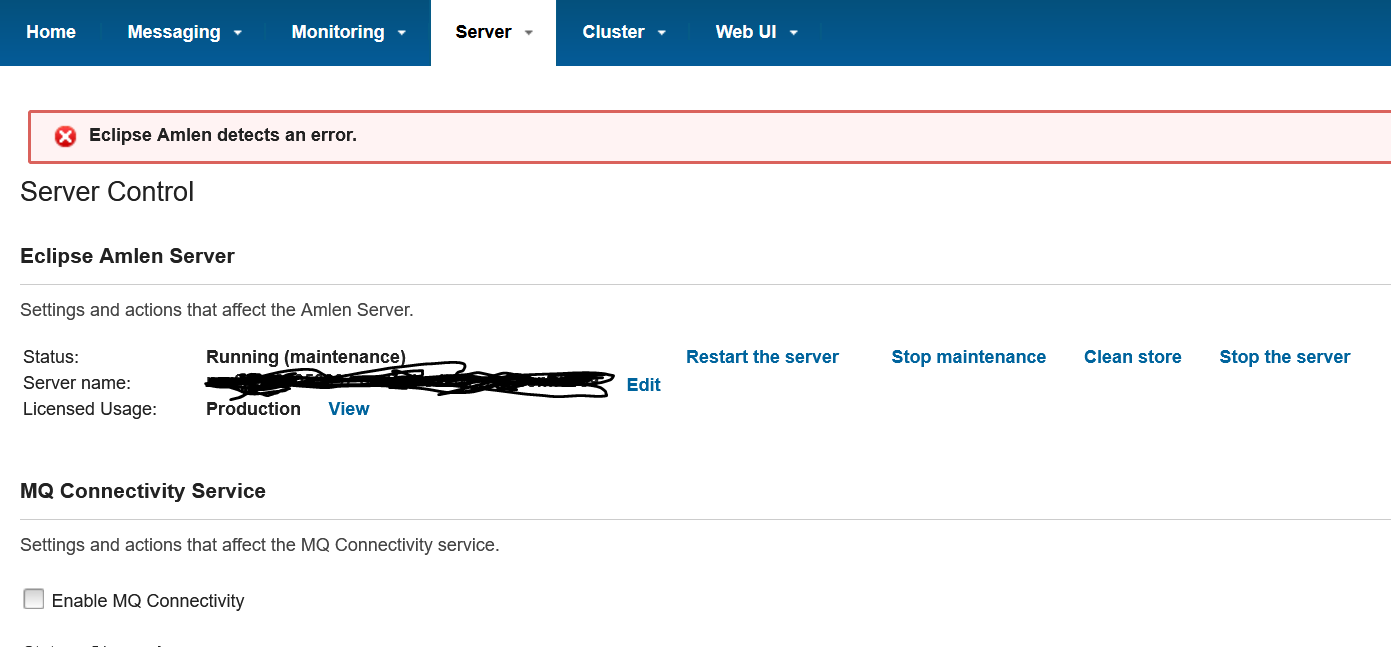

Re: Upgrading from IBM Watson IoT Platform Message Gateway to Eclipse Amlen [message #1859917 is a reply to message #1859573] Wed, 05 July 2023 06:17 Go to previous messageGo to next message
Hi Krzysztof,
I have upgrade our message sight application to Eclipse Amlen.
After installation, service are running and I am able to see the WEBUI.
But application status shows in Maintenance mode, I am unable to stop maintenance to restart it in production mode.
Can you please suggest here.
Re: Upgrading from IBM Watson IoT Platform Message Gateway to Eclipse Amlen [message #1859919 is a reply to message #1859917] Wed, 05 July 2023 08:12 Go to previous messageGo to next message
Hi Naveen,
Please have a look at this document: https://eclipse.dev/amlen/docs/Troubleshooting/tr00006_.html. Here is what it states:
There are several reasons that the Eclipse Amlen server state changes to maintenance mode:
There is a configuration error. For example:
High Availability might be configured with the wrong IP address for the local replication NIC.
The LDAP Bind DN password might be changed on the LDAP server, and therefore the Eclipse Amlen server cannot connect.
A certificate might be invalid or corrupted.
The system administrator sets the server state to Maintenance by using REST Administration APIs, or by using the Amlen WebUI. For more information changing the server state, see Changing the server state.
The store is corrupted and unrecoverable, or there are insufficient system resources to start the store. When any of these issues occur, the Eclipse Amlen server automatically changes the server state to Maintenance.
A pair of Eclipse Amlen servers in a high availability (HA) pair is incorrectly configured for cluster membership. One server in the HA pair might be configured for cluster membership but the other server in the HA pair might not be configured for cluster membership. For more information about configuring HA on cluster members, see Configuring HA.
To diagnose why the server is in maintenance mode, check the status of the server, and check the log files for possible causes. After you resolve the issue, you can change the server state from Maintenance. For more information about checking the status of the server and changing the server state, see Changing the server state.
If the store is corrupted and unrecoverable, or if there are insufficient system resources to start the store, you might need to clean the store. Cleaning the store deletes all persistent data, including messages, subscriptions, and client states. Do not clean the store unless you want to delete all persistent data on the system. For more information about cleaning the store, see Cleaning the store.
Please let us know if that helps.
Re: Upgrading from IBM Watson IoT Platform Message Gateway to Eclipse Amlen [message #1859921 is a reply to message #1859919] Wed, 05 July 2023 08:54 Go to previous messageGo to next message
Hi Chris,
Thank you for your reply.
and upon checking logs I can see below messages, saying "Set error "Store is not available." (500)". Should I try cleanup store ?
2023-07-05T14:50:00.503+02 logger config.c:3352: 2023-07-05T14:50:00.503+02:00 Admin AdminIOP CWLNA6129 E: The Amlen Server encountered an error while processing an administration request. The error code is 6209. The error string is "The Amlen Server status is \"Maintenance\". Any actions to \"Endpoint\" are not allowed.".
2023-07-05T14:50:20.198+02 AdminIOP store.c:333: Set error "Store is not available." (500)
2023-07-05T14:50:41.654+02 timer1 tcp.c:2849: Set error "No data was received on a connection." (164)
2023-07-05T14:50:41.654+02 logger tcp.c:838: 2023-07-05T14:50:41.654+02:00 Connection timer1 CWLNA1116 W: Closing TCP connection during handshake: ConnectionID=34 From=[10.12.242.39]:51021 Endpoint="AdminEndpoint" RC=164 Reason="No data was received on the connection" Uptime=118 ReadBytes=2,239 WriteBytes=1,221.
2023-07-05T14:50:41.654+02 logger tcp.c:838: 2023-07-05T14:50:41.654+02:00 Connection timer1 CWLNA1116 W: Closing TCP connection during handshake: ConnectionID=31 From=[10.12.242.39]:51019 Endpoint="AdminEndpoint" RC=164 Reason="No data was received on the connection" Uptime=118 ReadBytes=2,232 WriteBytes=1,221.
2023-07-05T14:50:41.654+02 logger tcp.c:838: 2023-07-05T14:50:41.654+02:00 Connection timer1 CWLNA1116 W: Closing TCP connection during handshake: ConnectionID=30 From=[10.12.242.39]:51017 Endpoint="AdminEndpoint" RC=164 Reason="No data was received on the connection" Uptime=118 ReadBytes=2,167 WriteBytes=1,234.
2023-07-05T14:50:51.294+02 AdminIOP store.c:333: Set error "Store is not available." (500)
Re: Upgrading from IBM Watson IoT Platform Message Gateway to Eclipse Amlen [message #1859922 is a reply to message #1859921] Wed, 05 July 2023 09:07 Go to previous messageGo to next message
Naveen M V wrote on Wed, 05 July 2023 08:54
Hi Chris,
Yes, try cleaning up the store.
Re: Upgrading from IBM Watson IoT Platform Message Gateway to Eclipse Amlen [message #1859923 is a reply to message #1859922] Wed, 05 July 2023 09:22 Go to previous message
Tried clean store , but facing same issue. Can you please let me know if we can have web session to check on the issue ?
