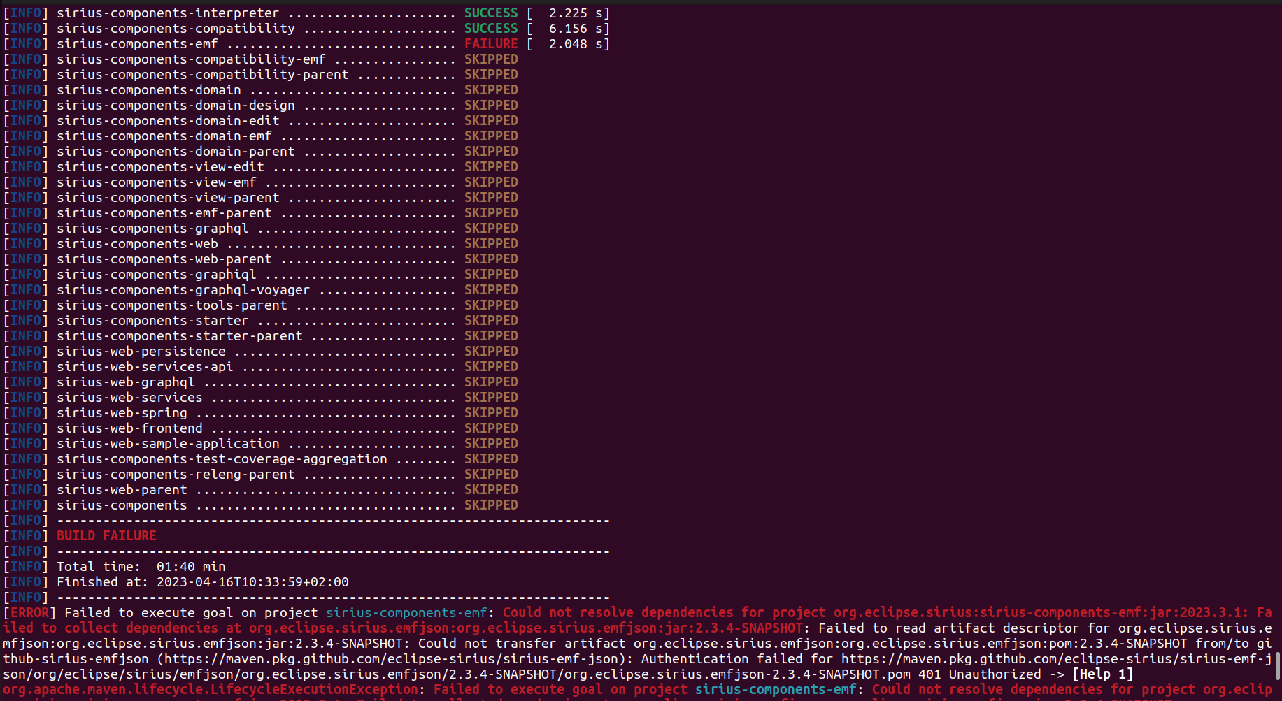

I have problem with build the backend components ( 4 step in this instruction https://github.com/eclipse-sirius/sirius-components#building). I have error:
[ERROR] Failed to execute goal on project sirius-components-emf: Could not resolve dependencies for project org.eclipse.sirius:sirius-components-emf:jar:2023.3.1: Failed to collect dependencies at org.eclipse.sirius.emfjson:org.eclipse.sirius.emfjson:jar:2.3.4-SNAPSHOT: Failed to read artifact descriptor for org.eclipse.sirius.emfjson:org.eclipse.sirius.emfjson:jar:2.3.4-SNAPSHOT: Could not transfer artifact org.eclipse.sirius.emfjson:org.eclipse.sirius.emfjson:pom:2.3.4-SNAPSHOT from/to github-sirius-emfjson (https://maven.pkg.github.com/eclipse-sirius/sirius-emf-json): Authentication failed for https://maven.pkg.github.com/eclipse-sirius/sirius-emf-json/org/eclipse/sirius/emfjson/org.eclipse.sirius.emfjson/2.3.4-SNAPSHOT/org.eclipse.sirius.emfjson-2.3.4-SNAPSHOT.pom 401 Unauthorized -> [Help 1]
org.apache.maven.lifecycle.LifecycleExecutionException: Failed to execute goal on project sirius-components-emf: Could not resolve dependencies for project org.eclipse.sirius:sirius-components-emf:jar:2023.3.1: Failed to collect dependencies at org.eclipse.sirius.emfjson:org.eclipse.sirius.emfjson:jar:2.3.4-SNAPSHOT
Could you help me?

This symptom is generally the sign of a missing or misconfigured GitHub Token.
Building Sirius Components requires acessing the JARs published by https://github.com/eclipse-sirius/sirius-emf-json on GitHub Packages's Maven repo, but even though this is a public repo from the same organisation, GitHub requires authenticating with a valid token.
See https://docs.github.com/en/packages/working-with-a-github-packages-registry/working-with-the-apache-maven-registry#authenticating-with-a-personal-access-token
