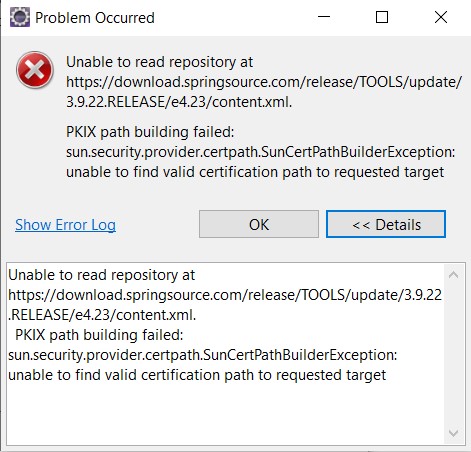

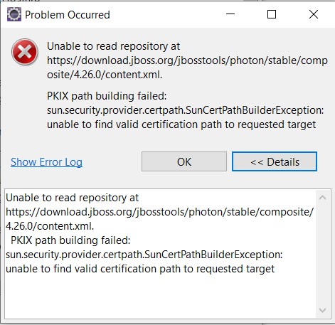

Hi everybody,
whenever i try to install an addon on eclipse 2022-06 jee,
i get the error in the attached images

Probably you are inside a corporate firewall that introduces certificates into the network traffic that are not rooted on a certificate in the JRE running the IDE.
Adding the two settings described here to the end of your eclipse.ini might fix the problem (though no one ever seems to come back to let us know whether or not that helps):
https://bugs.eclipse.org/bugs/show_bug.cgi?id=567504#c29
