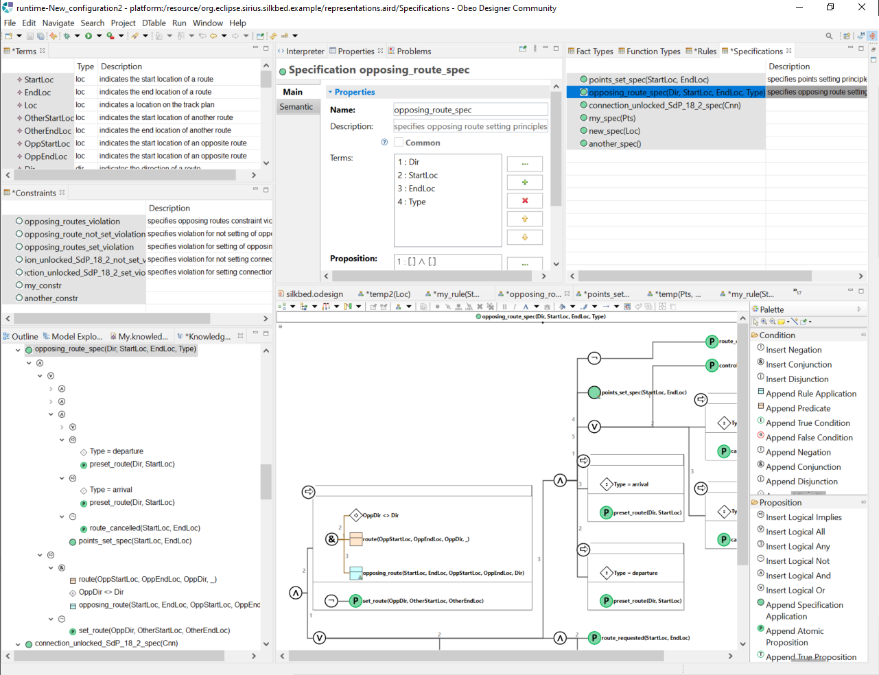

index.php/fa/43016/0/I have nearly completed a prototype for an editor for a particular DSL via the construction of a Sirius VSM.
I've managed to realise most of the requirments using just the eclipse/sirius API and acceleo queries, including validation of complex semantic conditions of the language.
I am now at the stage where I am anlaysing means to override some of the 'native behaviour' of the resulting VSM interface for which I would like some advice.
in particular, because I know or suspect that I will need to implement extensions in java for these.
The main behaviour is to do with the automatic diagram layout.
To provide some information, my VSM consists of diagram, table and tree representations and semantic class specific property views.
It is possible to construct and/or visualise the DSL model using different operations of each of these representations.
For example, in the case when a user constructs part of the model via the tree representation, the corresponding diagram is refreshed automically.
I've managed to specify the diagrams so that the automatic layout is almost as desired apart from the 'order' of the edges.
The diagrams are each comprised of nested containers with nodes and edges, using vertical stack / free form arrangements as illustrated in the attached screenshot.
Each type of a diagram has a Left to Right composite layout.
The edges are relational-based and are used to depict composite 1 to 1 or 1 to many relations.
For information, the 1 to many relations are specified in the domain model as ordered, unique, although I suppose that the native layout algorithm is not taking into account, because it probably creates all the nodes first and then creates the edges that connect them.
As you can see from the attached screenshot, the currently selected diagram is not layed out to show the edges in their specified order, if compared with the order of the corresponding tree items at the left of the diagram.
In fact, because the order is very significant to the DSL, I added numbers on the edge labels to indicate the order.
I've made a quick study of how to 'tailor' the layout algorithms provided in sirius, but my impression is that it would be necessary to implement a new algorithm (perhaps reusing some of the code from the existing ones).
What would be the easiest and/or most feasible way to arrange the diagrams so that:
. the whole/part relations are depicted from left to right (as they are now)
. the edges are depicted from top to bottom in ascending order of the relations?
