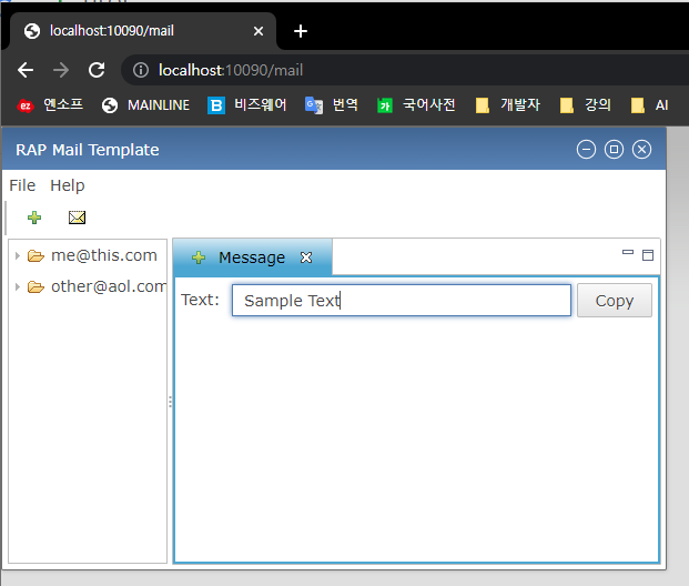

I wrote a sample program to reproduce this problem.
The mail template plugin of the RAP sample has been slightly modified and works as follows.
index.php/fa/43002/0/
This is a simple sample that saves the entered sentence to the clipboard when you enter a sentence in the text field and click the "Copy" button.
If you test with the URL below on the device where the server is running, it works perfectly.
http://localhost:Port/mail
but,
If you test by accessing the URL below from another device, an error occurs.
http://IP:Port/mail
Am I just not sure how to use it properly?
I hope so. ^^
Here's the code that implements clipboard handling:

  • Attachment: ClipboardTest.zip
    (Size: 30.81KB, Downloaded 105 times)
  • Attachment: OK.png
    (Size: 26.79KB, Downloaded 370 times)
