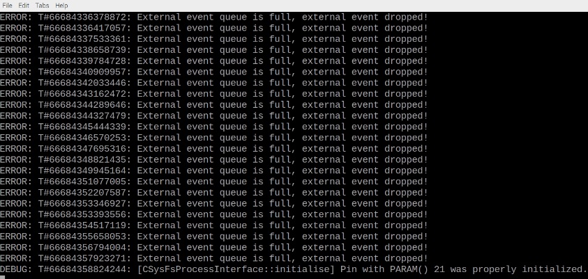

I want to control the IOs of Raspberry Pi. I am using 4DIAC IDE on a windows PC and connected the RPi through an ethernet cable.
I have made a model for simply blinking the GPIO 21 of the RPi. The FORTE is running on RPi. When I am deploying the model on Raspberry Pi it shows the error "External event queue is full, External event dropped".
Does anyone had the same problem and could resolve it? If so, please give the solution. For your reference, the FORTE screenshot is attached.

external event queue in nearly all cases means that you have either a blocking FB or that one of your FB crashes. Do you have a self writen FB? Can you share that?
Cheers,
Alois
