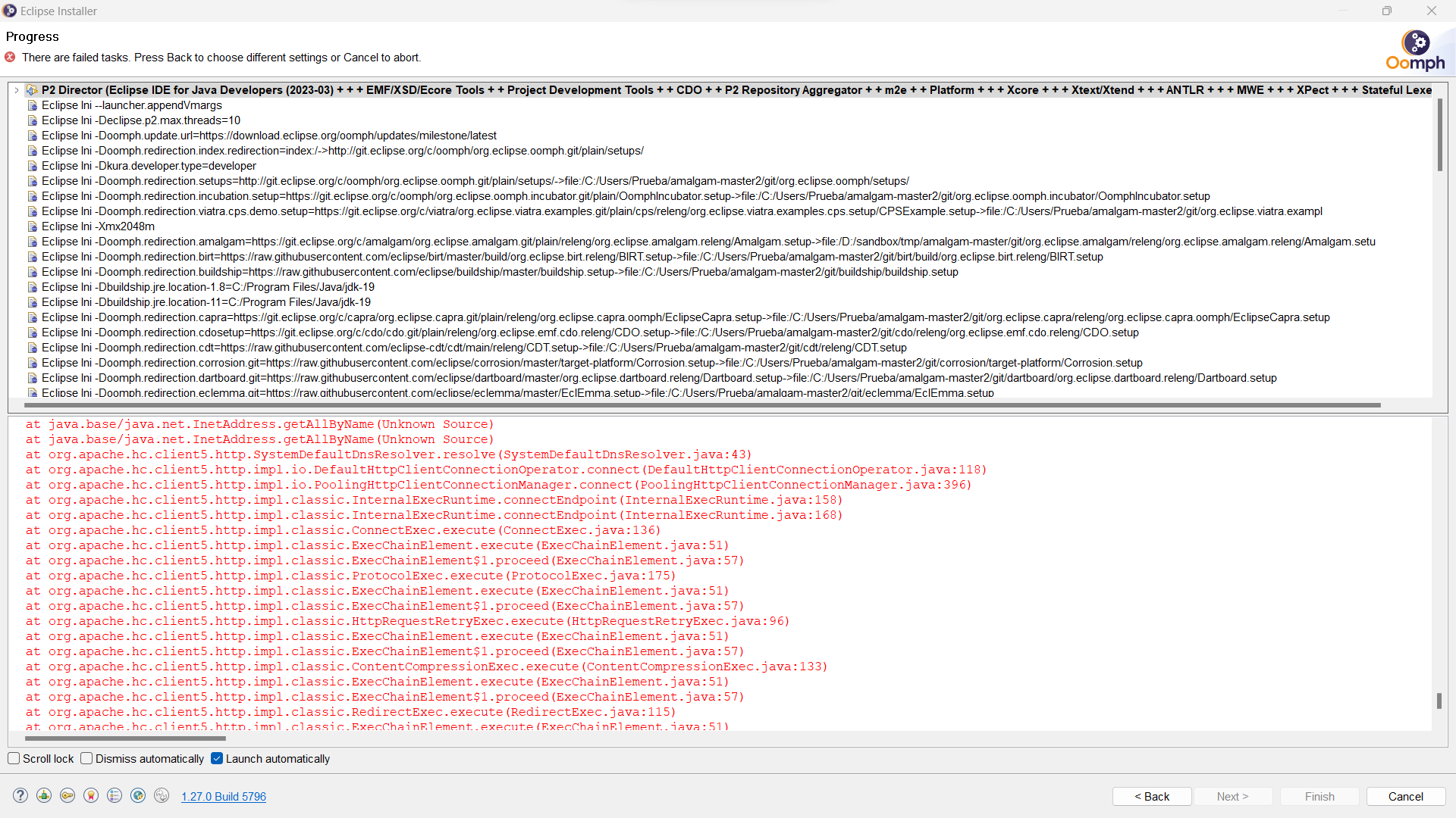

Home » Newcomers » Newcomers » I cant install eclipse(everytime i try to install it, this error log appears, i dont know what to do, i ve deleted all files of eclipse and install it again but htis error wont stop appearing)

It looks like you switched the installer to advanced mode, selected the latest 2023-03 (not yet released) version of the JEE product on the Product page, and then on the Project page you did a select all. Each Project you select on the second page will create an IDE specifically for working with that project, cloning the project's git clones, importing the contents into the workspace, and likely even installing additional tools for working with those projects. You did that for a great many Projects. I doubt that you want to select any Projects on the second page and I doubt you even want to use advanced mode. I expect you just want to select a Product on the first page and no Projects on the next page. Probably best you use the tool button at the bottom to switch back to simple mode.
