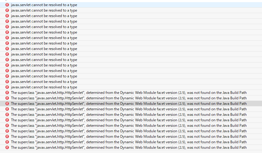

When I use Eclipse 2022-12 to import a web project using jakarta. servlet
Errors will occur in all jsp files
like this:
HttpServletRequest cannot be resolved to a type
javax.servlet cannot be resolved to a type
The superclass "javax.servlet.http.HttpServlet", determined from the Dynamic Web Module facet version (2.5), was not found on the Java Build Path
https://www.eclipse.org/forums/index.php?t=getfile&id=42798&
Although there are errors, it can still be started and run normally with tomcat
It seems that the problem from javax ->Jakarta
But for the same project, I did not have any errors in Eclipse 2022-03
Does anyone have the same problem?
Is this an Eclipse validation problem or is there something wrong with my project?

Since there's no post there, I'll point out that the error message is telling you why it thinks you want to use the old package name: your project is set to expect Servlet (Dynamic Web Module facet) 2.5, not 5.0. Change it.

Hi, Nitin Dahyabhai
My project uses 2.5. On the contrary, the error disappears when I use 5.0
This seems to be the opposite of the error message

Yes, because it is checking for the new jakarta package when the project is set to 5.0, it would not complain about missing javax.servlet.http.HttpServlet.
