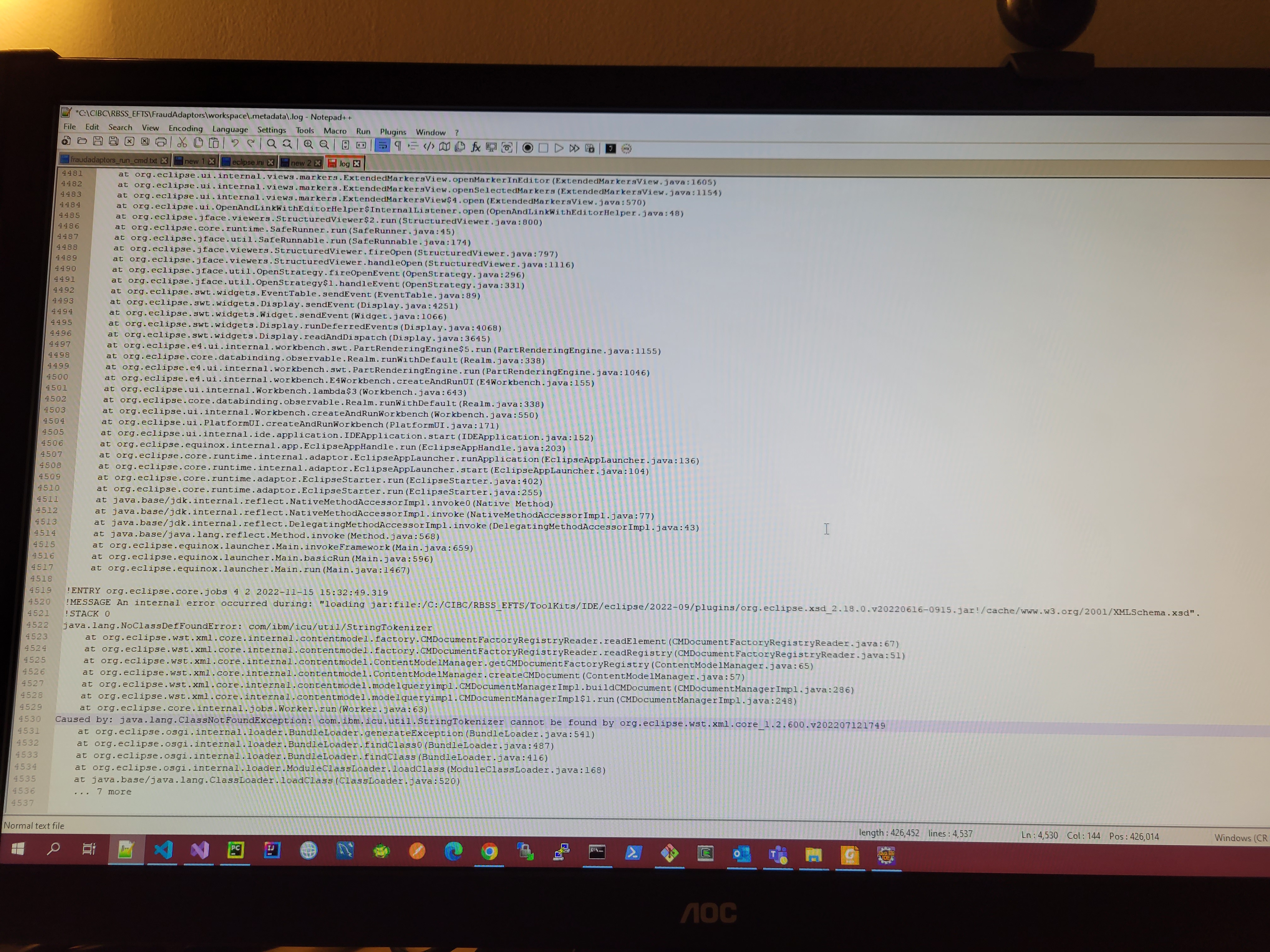

I am getting the below when i open a xml file.
 java.lang.NoClassDefFoundError: com/ibm/util/StringTokernizer
Seems to be due to plugins org.eclipse.xsd_2.18.0.v20220616-0915.jar
I have attached a screen shot of the error stacks in the attachment.
Appreciate any help.

(Most people use an error log cit and paste, else a screen shot tool; a literal photograph is hard to read.)
From what I can see, the problem is in wst, not xsd which has no com.ibm dependency.
The com.ibm functionality comprises functionality that was useful 10 years ago when Java lagged the evolving Unicode specification. Java Unicode has been good for a long time and the com.ibm functionality has become troublesome prompting many projects to eliminate it completely. YOu are therefore probably finding that something, possibly the platform is not providing the support that wst or jboss still requires. You need to explicitly include it yourself for now.

It's hard to tell from your snippets. The xsd was clearly 2022-06, but the photo shows a wst 2022-07, so maybe the problem is that the webtools team didn't test sufficient installation permutations of their 2022-09 contribution. You can try the 2022-12 wip, or as I suggested earlier just provide com.ibm.icu that something clearly needs in your installation.
