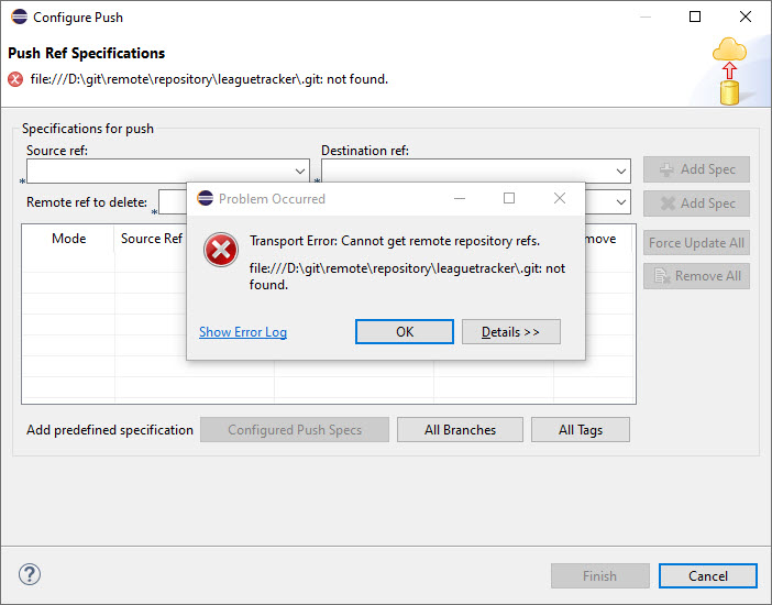

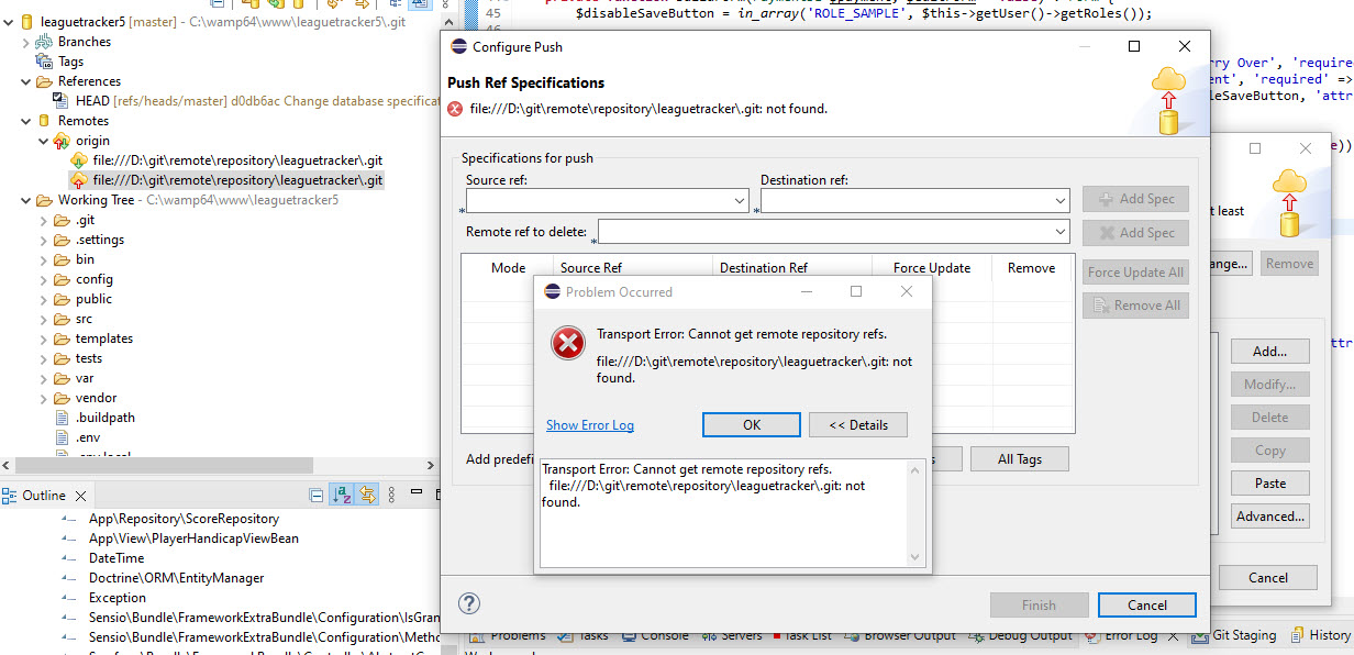

Using EGit, I've created my local repository and am attempting to set up a remote repository on a backup drive using the file protocol. I'm able to see thet the remote repository file:///D:\git\remote\repository\leaguetracker\.git has been created, but when I attempt to establish the push configuration I receive the error shown in the attach screen shot.

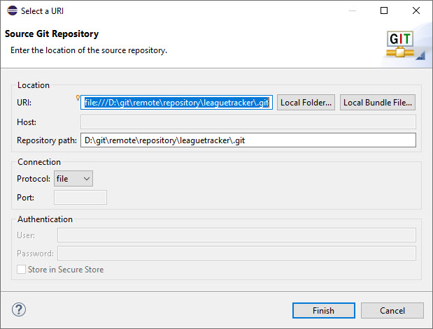

No. I tried that too just for the heck of it but I knew that was a long shot and that I was just grasping at straws. If you go through the configuration wizard to Create Remote ... you are presented with the dialog shown in the attached create-remote.jpg screenshot.
In this dialog I selected the Local Folder ... option and navigated to the directory where I want the remote repository to be created. The wizard filled in the URI specification from the path I navigate to and I didn't have to enter enter slashes or back slashes ... the wizard did this for me. So, I'm thinking the wizard knows best what it is doing for the Windows platform that I am on. Notice that it fills the file protocol as well so I'm thinking it knows what it's doing there as well.

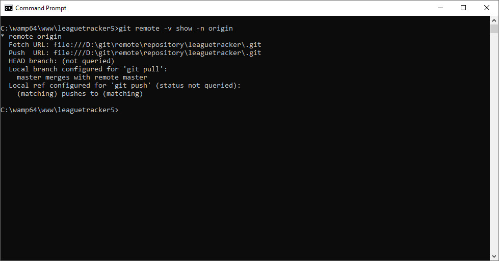

This was pretty straightforward and appears to be correct as I was able to use the git remote command to verify that the remote file repository was indeed created (see the created-repository.jpg screenshot).
I then try to setup the push specification and use the Advanced dialog to do that. This results in the error that I'm getting right away when clicking into that dialog (see advanced-push-dialog.jpg).
