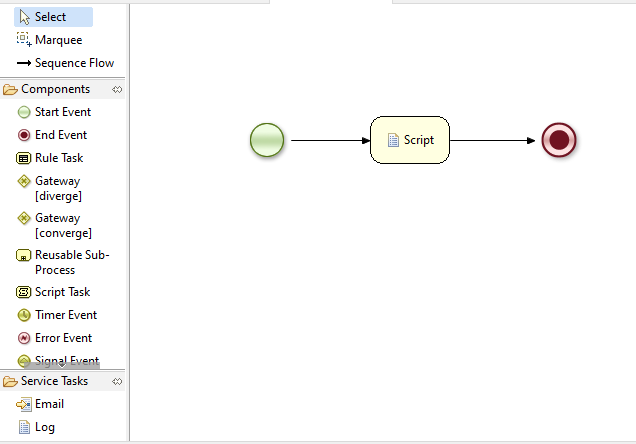

There are two ways to intall plugins for JBPM editing:
My first thy from my message above: Eclipse tools from update site "JBPM 7.48.0.Final - https://downloads.jboss.org/jbpm/release/7.48.0.Final/updatesite/"
These plugins produce the problem I described above.

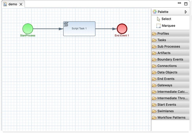

My second try: using the plugins from "Red Hat Business Process and Rules Development (BPEL, BPMN2, jBPM, Drools) - https://devstudio.redhat.com/12/stable/composite/integration-stack/12.11.0.GA/"
This Time the editor looks different and does not produce the wrong id attributes of BPMN diagram nodes.
index.php/fa/42532/0/
So, JBOSS and Red Hat and JBPM are related, aren't they? Whats wrong? Why does the original JBPM editor not work? I will try to raise a bug ticket at jBPM.
