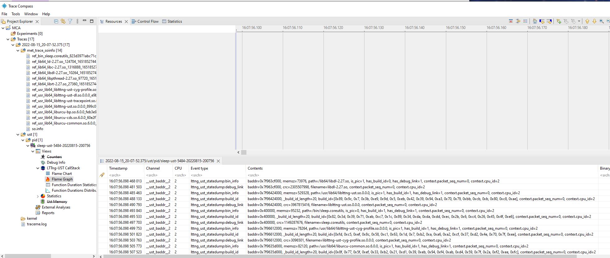

I spent sometime last night to try and understand the issue. The traces are produced by LTTNG but on the ARM64. They load up into the tool as expected. It reads the log file fine but does not interpret the rest of the files properly.
Based on my examination of the file formats, they seem to be binary even though they have a lot of text intermixed in the files. The text that I see are the tasks and markers of my running system so it looks very familiar. My assumption is that this a big endian/little endian issue, so I was wondering if there was a option to save them in a known format or a converter to go between the two formats?
Attached is capture of the tool after trying to load the traces.
Thanks.

Looking at the screen hot it looks like the trace is a User Space trace (UST). The events table seems to be populated. For UST only certain views are available by default because the UST tracepoints are application specific. By default, you see the Events Table, Statistics View/Event density and Histogram. You can also use the Filter view or Color view for highlighting events in the table. If the application was compiled with gcc's finstrument-functions and the tracer started with pre-loading a specific lib, you will see the Flame Chart, Flame Graph and function duration statistics etc populated as well. Similar feature exists for memory analysis. See [1] for LTTng-UST analysis available and how to make them work, [2] is about tracing function entry/exit and [3] about memory analysis.
The view Control Flow view or Resources view are populated for LTTng kernel traces, that why they are currently empty. You need collect the kernel trace with LTTng as well. If you add kernel and UST trace in one "Experiment" and open it, then you can see them together and in table the events are interleaved.
