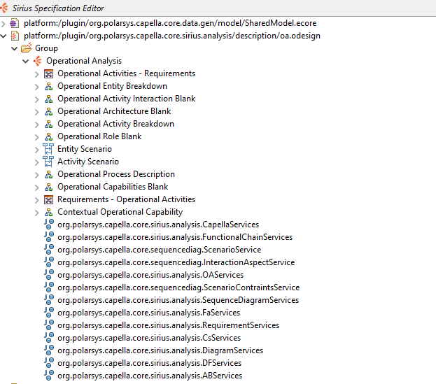

In this example of sirius specifier, we got a number of services that are defined under the viewpoint (Operational Analysis) (See attached picture).
Question: Can you call upon the functions /services of this viewpoint from a different viewpoint? How does that work?

The services are not really defined under the viewpoint. They are register in it. So you can reuse it , by registering it in another viewpoint, by adding a Java extension. For more detail, you can read this documentation: https://www.eclipse.org/sirius/doc/specifier/general/Writing_Queries.html#service_methods

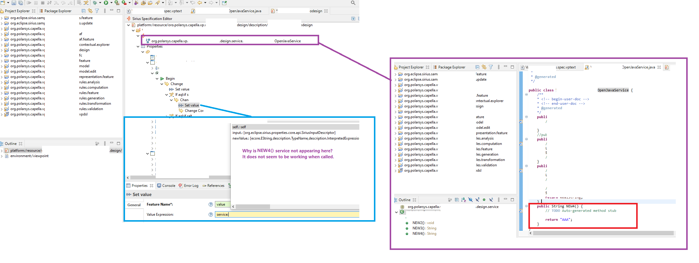

Hello Laurent,
But it does not seem to be working right, look at this image (attached).
I made the function NEW4(), and tried to assign the value returned ( string) to a variable that hold a string (context was changed correctly). yet nothing happens.
What is more alarming is that the function DOES NOT APPEAR when you do a CTRL+SPACE. That's kind of a ring flag, it indicates that it is not working as intended, Am I wrong?
Please verify this. I made this whole topic just because I felt the Property value description did not take the service the viewpoint in the end. Something is off. Could you investigate please?

Your NEW4 Java service method is not valid. It does not follow the rules mentioned in the documentation, and in particular:
A service method must take at least one parameter, which should be an EMF type (i.e. EObject or a sub-type of EObject).

Hello Pierre-Charles
Thank you so much!
This reminds me a bit of tables in the Sirius Specifier, you have to give it a Attribute that exists THEN you can change the context to anything you want. BUT You need to put an existing Attribute even if you don't want to use it.
In my java service, I had to add an Eobject as parameter as you suggested, then I CAN IGNORE that parameter and return whatever I want.
It's quite curious but it works somehow.
