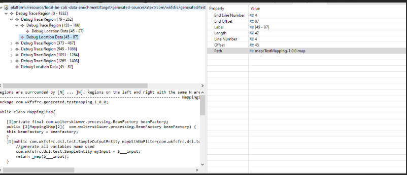

When we generate our xtext project with maven and we have a look at the ._trace file we see that the path is a full path link to the workspace. see picture debuglocationMaven.PNG
index.php/fa/42297/0/
Although afterwards we generate with the incremental build of eclipse we get the correct path for eclipse with a shorten path.
(see debuglocationEclipse.png)
index.php/fa/42298/0/
Where are these paths specified, and how come that these can be different?

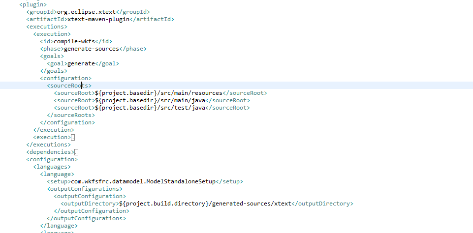

Re: _trace file Debug location data path different on eclipse incremental build and maven [message #1854028 is a reply to message #1853694] Thu, 28 July 2022 09:55 Go to previous messageGo to next message
This is our xtexxt-maven-plugin
I collapsed all deps we used and a part of the languages
index.php/fa/42350/0/

You're using absolute paths in your plugin configuration (project.basedir and project.build.directory are transformed into absolute path during the Maven build).
You should use a simple relative path (e.g., "src/main", no backslash at the beginning; similar for the output directory).
