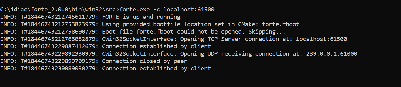

It seems that the socket is ok, at the prompt I got the message from forte:
INFO: T#18446743515581449808: CWin32SocketInterface: Opening UDP receiving connection at: 239.0.0.1:61000
index.php/fa/42155/0/

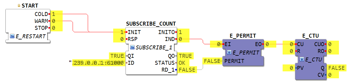

But the Counter App is not able to read the data the Blink App is publising.
If I watch the Counter App there is no pulse on Subscribe FB's "IND" event.
index.php/fa/42156/0/

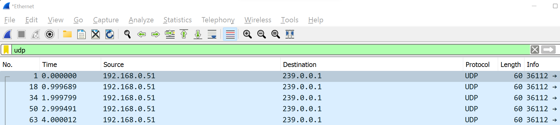

What is intriguing is that on Wireshark I can see that packages are coming from RPI to PC, but 4diac's subscribe FB seems dead.
index.php/fa/42184/0/
