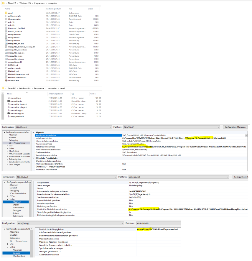

I am not able to create a MQTT client because of a linker error.
The problem is not in the mosquitto lib. Probably the problem are the visual studio settings or a worng file path of my mosquitto installation.
Hopefully a lot of you use visual studio and can advice.
I installed mosquitto with this installer mosquitto-2.0.14-install-windows-x64.exe.
The file structure and the visual studio settings you can see on the pic attached.
The erroe i get is
LNK2019 unresolved external symbol "_imp_mosquitto_lib_init"
This source code cause this problem.
