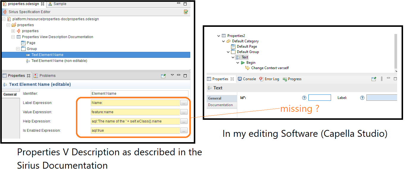

I am reading the documentation which mentions three options to create a PVD:
- The first menu is used to create a blank Properties View description. With this menu, you will start your Property View definition from scratch.
- The second menu can copy the default rules directly inside of the odesign. While powerful, those default rules can be quite complex for new users.
- The third menu can create a new Properties View which will extends the default rules. Using this mechanism, you can leverage all the default rules and you have the ability to easily add new rules.
However as you can see in the attached image, i have got only the first option, and I am using Capella Studio.
Is any reason why I would not have the 2 other options?
Thanks.
Re: Creating a Property View Description [message #1851617 is a reply to message #1851615] Mon, 11 April 2022 06:29 Go to previous messageGo to next message
Same Observation for the common attributes, (Check the attached image)
Am I missing something?

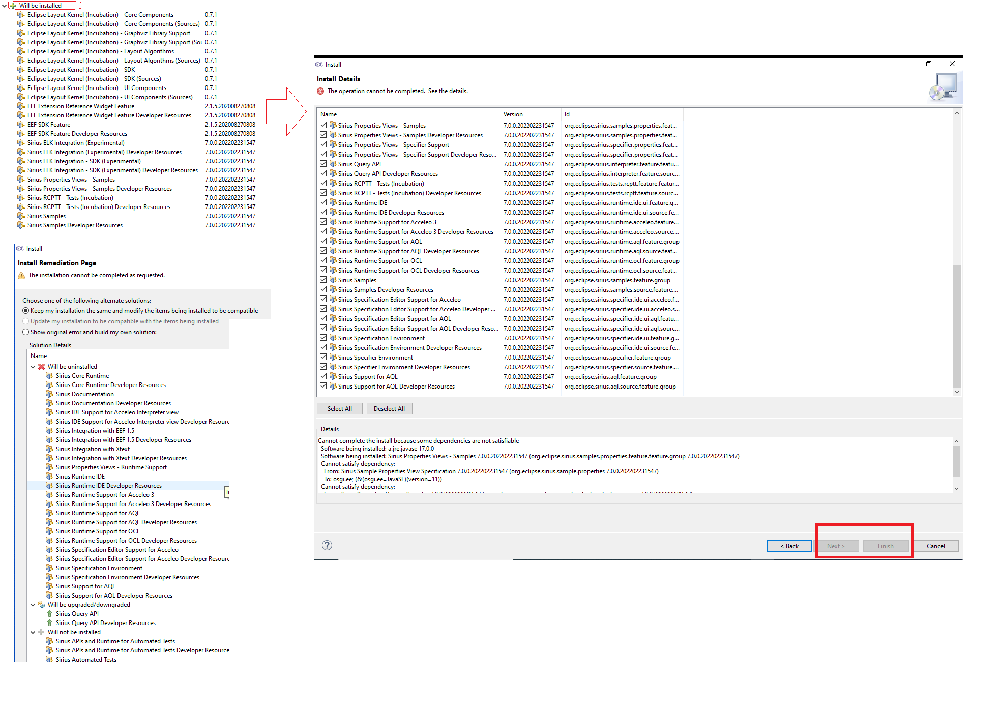

Indeed, there is a number of Sirius elements that are missing, but when it comes to the specified he would not include them in the "to be installed".
Here is an attached image.
The attached message:
"Cannot complete the install because some dependencies are not satisfiable
Software being installed: a.jre.javase 17.0.0
Software being installed: Sirius Properties Views - Samples 7.0.0.202202231547 (org.eclipse.sirius.samples.properties.feature.feature.group 7.0.0.202202231547)
Cannot satisfy dependency:
From: Sirius Sample Properties View Specification 7.0.0.202202231547 (org.eclipse.sirius.sample.properties 7.0.0.202202231547)
To: osgi.ee; (&(osgi.ee=JavaSE)(version=11))
From: Sirius Properties Views - Samples 7.0.0.202202231547 (org.eclipse.sirius.samples.properties.feature.feature.group 7.0.0.202202231547)
To: org.eclipse.equinox.p2.iu; org.eclipse.sirius.sample.properties [7.0.0.202202231547,7.0.0.202202231547]"
This was with Sirius 7.0 last version.
I tried neon 5.0 version and i would not get that incompatibilty error message, the installation went through, but same as the other, the specifier was not included.
Any solution in your opinion?

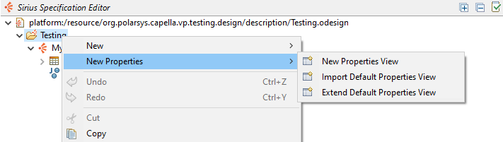

Re: Creating a Property View Description [message #1851695 is a reply to message #1851685] Tue, 12 April 2022 10:30 Go to previous messageGo to next message
I checked my "feature" folder and it seems to contain sirius 6.5.1, so i went through and downloaded sirius 6.5.1 (I am using CS 5.1 so that's understandable now)
it worked!
Attached image.
Thanks a lot.
