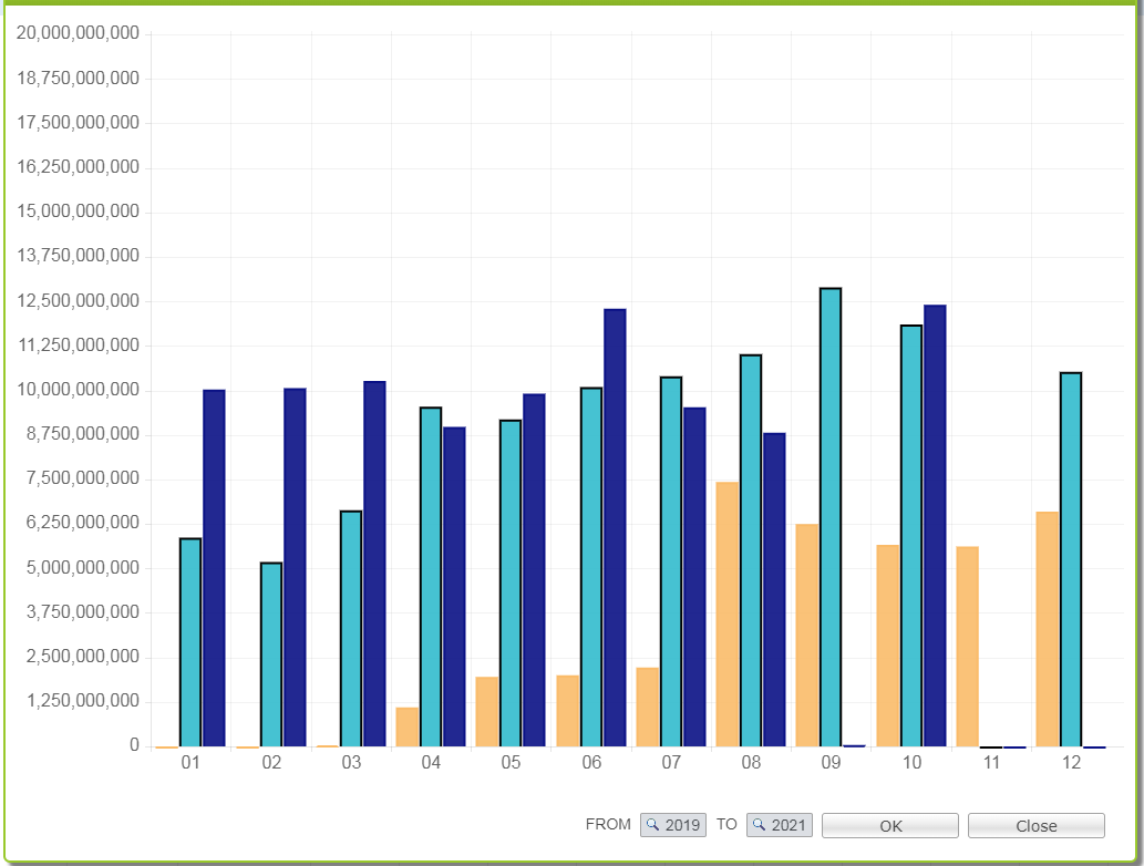

When using Bar chart to show data for every months of 3 years, we'll specify 3 colors for the 3 years, each color represents one year(12 bars), then how to show "labels & years" on the top of the chart?
It usually looks like a small square filled with a color(same as its corresponding bars'), and followed with the year number right side, users can tell which color is which year by "labels & years" indicator.

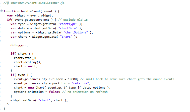

just a hint - please check "org/eclipse/rap/chartjs/internal/ChartPaintListener.js" where the chart options from the server are applied to the client widget.

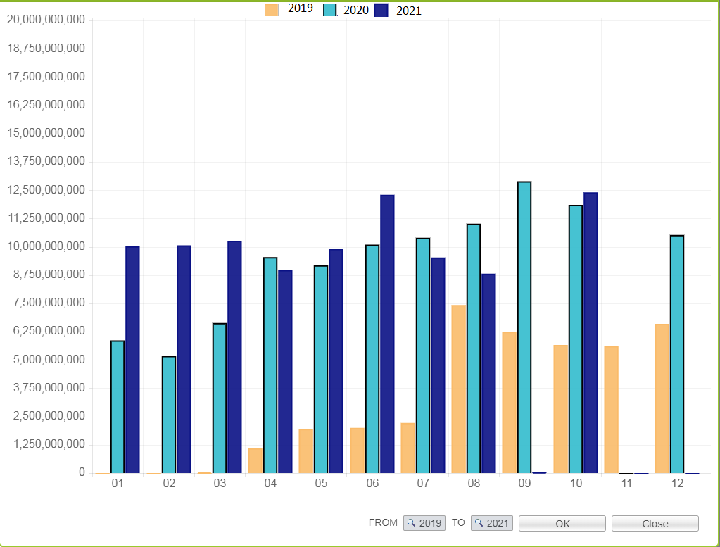

What I need is shown like the attached picture, "color and year number" on the top of the chart.

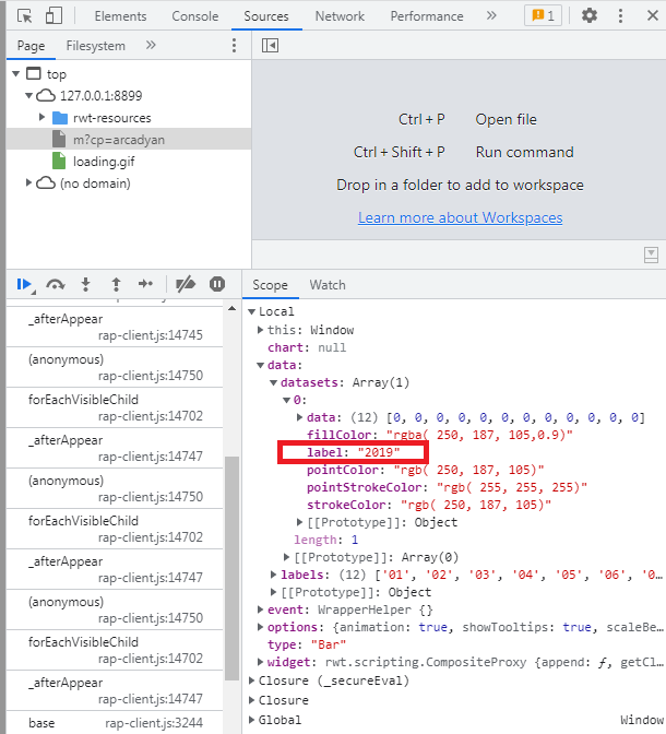

I put 'debugger' in the function handleEvent( event ) {} of "org/eclipse/rap/chartjs/internal/ChartPaintListener.js", the "label" was indeed transferred to dataset.label, but it's not shown on the top of chart!
