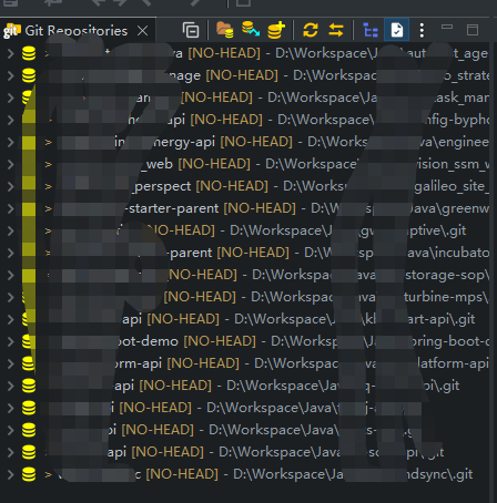

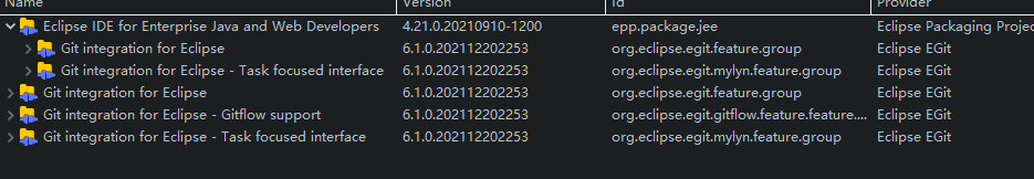

All java projects is ok before upgrading git plugin
After upgrading the git plugin , all github/gitlab java projects become "NO_HEAD"
index.php/fa/41481/0/
index.php/fa/41482/0/
How to fix?

I cannot reproduce this. Which EGit version did you upgrade from?
Re: all github/gitlab java projects become "NO_HEAD" after upgrade git plugin [message #1848917 is a reply to message #1848905] Thu, 23 December 2021 09:01 Go to previous messageGo to next message
I am experiencing the same issue. After installing this update all local repositories become disconnected from Eclipse and [NO-HEAD] is shown in every project. Remote repositories are still showing and connected.
Re: all github/gitlab java projects become "NO_HEAD" after upgrade git plugin [message #1848918 is a reply to message #1848917] Thu, 23 December 2021 10:22 Go to previous messageGo to next message
@Terry: also on Windows? And what version of EGit did you upgrade from? Where are your git repositories located in the file system? Inside the Eclipse workspace, or outside?
Re: all github/gitlab java projects become "NO_HEAD" after upgrade git plugin [message #1848927 is a reply to message #1848918] Thu, 23 December 2021 17:01 Go to previous messageGo to next message
Can reproduce now. Seems to be Windows-specific, and only with EGit nightly (6.1.x). EGit 6.0.x is fine; EGit nightly on OS X is fine, too. Manual restart of Eclipse doesn't help.
Also appears to affect all repositories, not just clones from Gitlab/Github. I also see it for a local repository.
Given that no changes in any related area occurred in EGit since 6.0, I guess some change in JGit causes this. Investigating...
[Updated on: Thu, 23 December 2021 17:44] by Moderator
Re: all github/gitlab java projects become "NO_HEAD" after upgrade git plugin [message #1848929 is a reply to message #1848927] Thu, 23 December 2021 18:53 Go to previous messageGo to next message
I've opened bug 577954 for this. It is a JGit problem.
Re: all github/gitlab java projects become "NO_HEAD" after upgrade git plugin [message #1848962 is a reply to message #1848929] Mon, 27 December 2021 04:24 Go to previous message
This is fixed in EGit nightly now. (JGit version 6.1.0.202112270830.)
