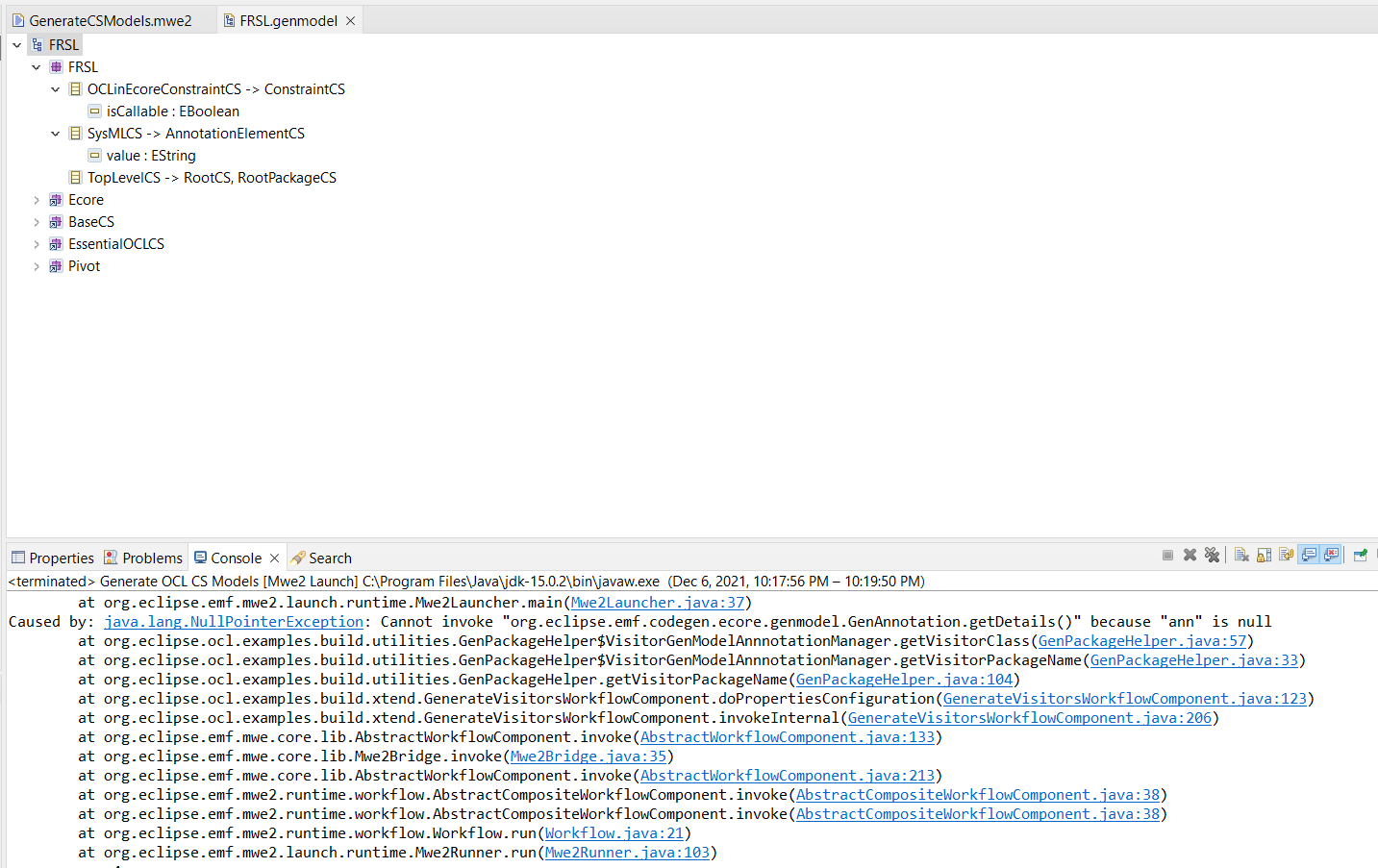

I am integrating OCL expression into my DSL that is the same as OclInEcore open source for final exam.
I hava git clone the OCL open source
First of all, i realize that GenerateCSModels.mwe2 in org.eclipse.ocl.examples.build source code which generate Concrete Syntax Models (it's located in the emf-gen folder) with the input file .genmodel.
With this GenerateCSModels.mwe2 file, the config path to .genmodel in oclinecore prj is normal. But I have created a new project, with my .genmodel file exactly the same as the .genmodel in oclinecore prj and I modify the config to my .genmodel in GenerateCSModels.mwe2 then run it i got the below error.
Prj I have created :"org.xtext.example.frsl" and the the location of .genmodel "model/custom/FRSL.genmodel". All config path are correct.
The img above is my .genmodel, which is the same as Oclinecore genmodel
Can someone help me? Please
My xtex: 2.25, Eclipse IDE: 2021-09 (4.21.0)
Caused by: java.lang.NullPointerException: Cannot invoke "org.eclipse.emf.codegen.ecore.genmodel.GenAnnotation.getDetails()" because "ann" is null
	at org.eclipse.ocl.examples.build.utilities.GenPackageHelper$VisitorGenModelAnnnotationManager.getVisitorClass(GenPackageHelper.java:57)
	at org.eclipse.ocl.examples.build.utilities.GenPackageHelper$VisitorGenModelAnnnotationManager.getVisitorPackageName(GenPackageHelper.java:33)
	at org.eclipse.ocl.examples.build.utilities.GenPackageHelper.getVisitorPackageName(GenPackageHelper.java:104)
	at org.eclipse.ocl.examples.build.xtend.GenerateVisitorsWorkflowComponent.doPropertiesConfiguration(GenerateVisitorsWorkflowComponent.java:123)
	at org.eclipse.ocl.examples.build.xtend.GenerateVisitorsWorkflowComponent.invokeInternal(GenerateVisitorsWorkflowComponent.java:206)
	at org.eclipse.emf.mwe.core.lib.AbstractWorkflowComponent.invoke(AbstractWorkflowComponent.java:133)
	at org.eclipse.emf.mwe.core.lib.Mwe2Bridge.invoke(Mwe2Bridge.java:35)
	at org.eclipse.emf.mwe.core.lib.AbstractWorkflowComponent.invoke(AbstractWorkflowComponent.java:213)
	at org.eclipse.emf.mwe2.runtime.workflow.AbstractCompositeWorkflowComponent.invoke(AbstractCompositeWorkflowComponent.java:38)
	at org.eclipse.emf.mwe2.runtime.workflow.Workflow.run(Workflow.java:21)
	at org.eclipse.emf.mwe2.launch.runtime.Mwe2Runner.run(Mwe2Runner.java:103)
	... 4 more

If you debug the NPE, or just look at the crashing source code you will see that the problem is that "ann" is null because OCLGenModelUtil.OCL_GENMODEL_VISITOR_URI is missing. This is http://www.eclipse.org/OCL/GenModel/Visitor.
If you Google "OCL http://www.eclipse.org/OCL/GenModel/Visitor" (to avoid the bogus use of just "http://www.eclipse.org/OCL/GenModel/Visitor") you will get pointed at chapter 9 of the OCL documentation. "Building the OCL Project" , "GenModel GenAnnotations".
If you compare e.g. /org.eclipse.ocl.xtext.oclinecore/model/OCLinEcoreCS.genmodel with your frsl.genmodel you will see that you have omitted the GenAnnotatons that configure the MWE2 activoties. Since this is a build script I regard the close to the point NPE an adequate diagnosis.
I notice that your frsl.genmodel claims to be autogenerated by Xtext. I gave up on autogenerated ecore/genmodel years ago since they do not handle an adequate diversity of modeling use casesand IIRC use inconsistent references to other models. Always maintain your ecore/genmodel manually. .

Oh it is true that i am missing xmi genAnnotation when i open frsl.genmodel with text.
I can't find how to add genAnnotation with EDITOR of .genmodel. I have to add by xmi code, Right ?

Fort multi-line edits I often resort to a text editor, yes.
But if you have checked Show GenAnnotations in the main tool bar Generate menu, you can see and edit GenAnnotations just like anything else. It is far from clear why the default is so unhelpful. Most users have no GenAnnotations so don't; those with GenAnnotations can be confused.
