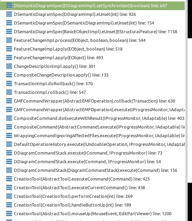

Re: Diagram tools create node location [message #1848790 is a reply to message #1848713] Fri, 17 December 2021 01:44 Go to previous messageGo to next message
Hi again. I'm having some issues trying out your solution, I did what you said, but in between the two calls to setSynchronized, there is another call from somewhere else, setting it back to true and throwing an exception.
I am using a change service action to create the model changes, which in turn is automatically updated in the diagram, if that makes any difference. I'm not sure why it is being set back...
Here is the stack from when setSynchronized is mysteriously called:
  • Attachment: stack.jpg
    (Size: 515.34KB, Downloaded 142 times)
Re: Diagram tools create node location [message #1848811 is a reply to message #1848790] Fri, 17 December 2021 12:15 Go to previous messageGo to next message
Hi Erik,
Can you run it in debug mode and place a breakpoint in GMFCommandWrapper.rollback? In the middle of the stack you see that the execute method calls the rollback (that is why you have a setSynchronized at false, it is reverting your change). You probably have an exception that cause this, you may find the reason there. Did you had anything more than the setSynchronized(false) to your creation tool?
Steve

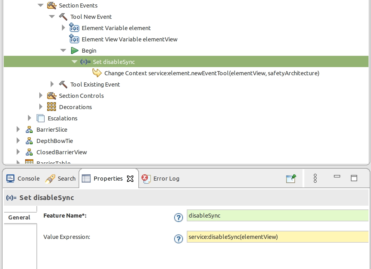

Re: Diagram tools create node location [message #1848955 is a reply to message #1848811] Sun, 26 December 2021 22:30 Go to previous messageGo to next message
Hi again, sorry for the delay.
I think maybe something is wrong with using a set operation, or maybe I just misunderstood? The service is being called correctly, which sets synchronized to false on the diagram. But then the rollback happens because it is trying to find an eStructualFeature of the target of the diagram with whatever name I put in the set operation in the .odesign. But the target of the diagram is just a node from our model, which doesn't have any features with whatever name I give, so the rollback happens. I also tried it as a change context instead of a set operation, which throws:
java.lang.IllegalStateException: Cannot modify resource set without a write transaction
I attached an image of the relevant parts in the odesign.
Thanks, and happy holidays!
Erik
  • Attachment: odesign.jpg
    (Size: 213.80KB, Downloaded 145 times)
Re: Diagram tools create node location [message #1848970 is a reply to message #1848955] Mon, 27 December 2021 10:16 Go to previous messageGo to next message
Hi Erik,
No problem. Indeed, you can change the synchronization, only on a DDiagram element (see org.eclipse.sirius.diagram.DDiagram.isSynchronized()) so in you service disableSync from your DDiagramElement you will need to call getParentDiagram.
From a ChangeContext Sirius only expect that you return a semantic element, you should call services that modifies the model from a "Set" model operation so it will be executed in a RecordingCommand (EMF Transaction).
Happy holidays to you too,
Steve
