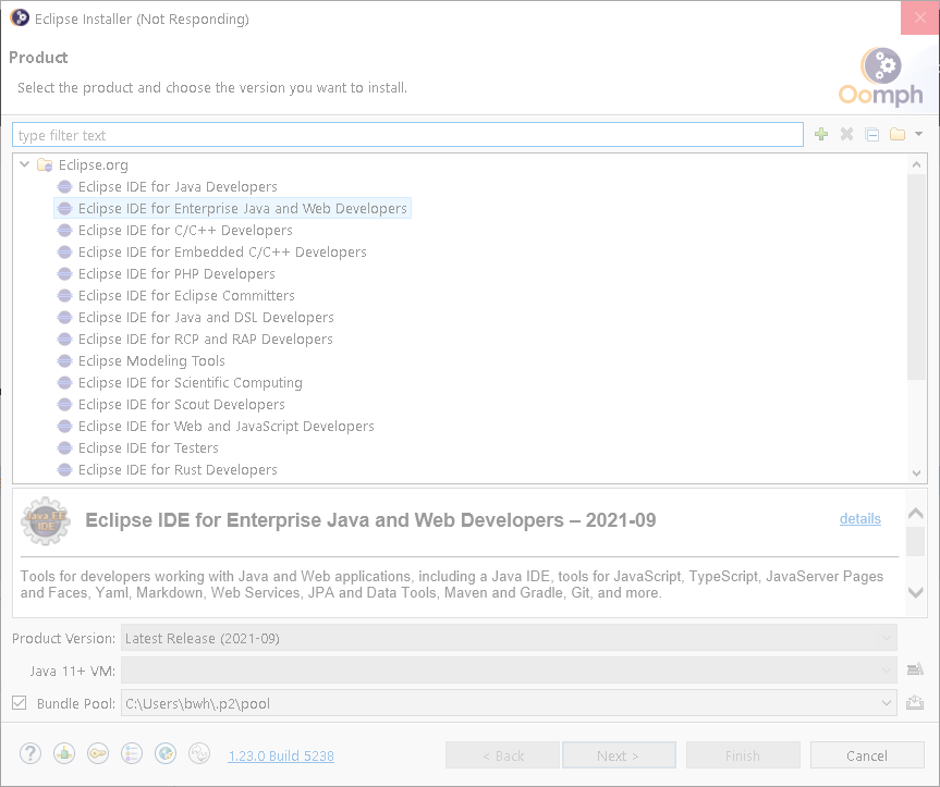

I have previously installed eclipse and have removed it in order to install the latest version. After downloading and starting the installer on first step the installer gets frozen / hangs / not responding (see attached screenshot). I cannot got further with installation and no log file seems to be available.
Every tip / hint is appreciated to surround that issue.

That's a problem I've never seen reported before. You're in advanced mode in this picture.. That's not the mode it comes up in by default when you first download the installer. Is this a freshly downloaded installer? Did you use the menu to switch to advanced mode to get into this state? When you say you removed eclipse, what folder(s) did you remove?

When installing, as soon as I select "Eclipse IDE for Enterprise Java and Web Developers" in the next step the window is frozen and I cannot continue. Also the default installation path provides this issue (see attached screenshot). The downloaded installer is the latest one downloaded today. I had this issue also when the old version of Eclipse was installed / available before. I removed it in order to ensure the issue was not produced by an old installed version of Eclipse. I removed the installation directory, the .p2 directory. The installation has been done on Windows 10.

Sorry, but the picture you show in the latest screen shot is in simple mode; the advance mode picture shown previously is not the one that will be next in the event sequence. The latest picture shows a blank "Java 11+ VM" entry and you won't be able to proceed unless there is a valid Java VM choice; Java 11 or higher. You say this too is frozen, but differently. You mention that "the default installation path provides the issue" but I don't know what you mean by that.

thanks again for your response. I have tested the installation in 2 ways, which both leads to the frozen windows as shown in the screenshots. by default installation path I meant after the first installation window appears (as seen in my second screenshot on the left hand side) and then choose the installation package (in my case "Eclipse IDE for Enterprise Java and Web Developers") the following window gets immediately frozen (as seen in my second screenshot on the right hand side). I do not have the chance to select a Java VM as the window is already frozen right after it appears.
Secondly I tried not to select an installation package first, but got to advanced mode using the upper right menu bar on the first window, which offers among others the advanced mode. But in that case, as soon as this window appears it gets immediately frozen as well (as seen in my first screenshot).

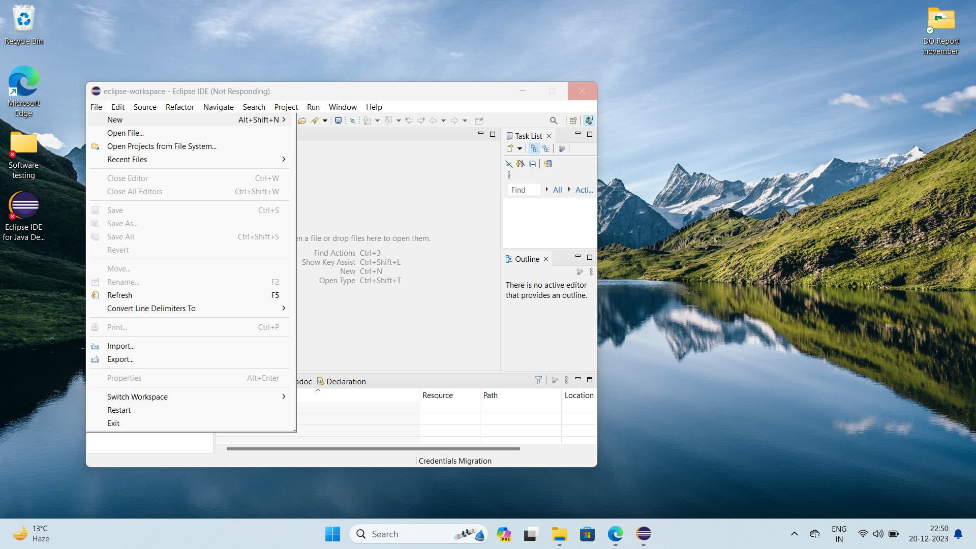

I've been facing a similar issue. But instead of freezing, it gets launched and throws an error. "Not responding".
Please see attached screeshot.

Your picture is not that of the installer. You can report problems for the IDE here:
https://github.com/eclipse-platform/eclipse.platform.ui
You'll need to provide more information:
https://wiki.eclipse.org/How_to_report_a_deadlock
Perhaps there is information in the Error Log view...
