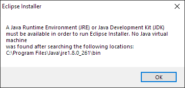

According to the installer it's version
plugins/org.eclipse.equinox.launcher_1.5.700.v20200207-2156.jar
I have OpenJDK 17 installed, among others.
I was trying to reinstall eclipse because my version suddenly stopped auto-completing anything in java.awt.*. I see from other threads here that java.awt.* is now built-out. so... what is the new hotness that everyone uses to make interfaces? I'm deep into GridBagConstraints.

That's the thing - I have newer JRE/JDK, so why is the installer looking in the wrong place? IDK where to file a ticket.
Re: Eclipse installer can't find my jdk or jre [message #1847904 is a reply to message #1847900] Fri, 12 November 2021 00:43 Go to previous message
I don't know which installer you are using, but the latest ones contain a JRE so would not have the problem you show. The older installers look in the registry (but the Java vendors keep changing the keys under which they store the information such that an other installer can't find a newer JRE at a newer key location). The installers also look on your PATH and JAVA_HOME environment variables and is not finding a JRE there either. Perhaps it's finding stale entries in your registry or in those environment variables.

But the problem you are trying to fix is easily addressed via Nitin's suggestion.
