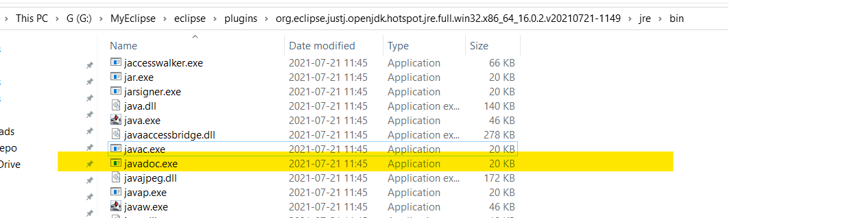

I also use java for my own mental exercise.... Using "Eclipse IDE for Java Developers".
I "install" eclipse by unzipping eclipse-java-2021-09-R-win32-x86_64.zip (in may case G:\MyEclipse\eclipse).
Looking at the setting tab, Eclipse now days come with its own JRE.
index.php/fa/41206/0/
This JRE also have javac.exe, so we have the whole show.
index.php/fa/41207/0/
This setting tab also allows us to add other JDK. In my case I have OpenJDK 17 in C:\Java

Eitan Rosenberg wrote on Sat, 30 October 2021 06:15
Regards.
Perfect! Many thanks.
