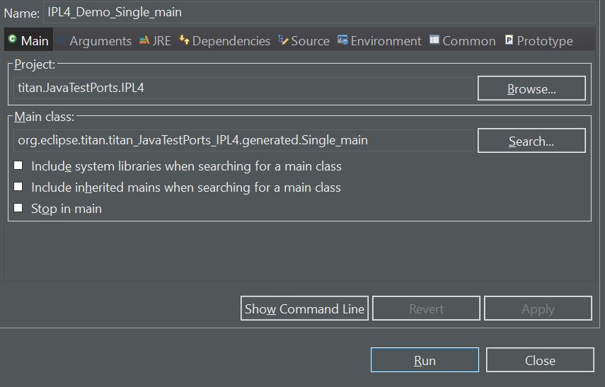

Right-Click to Project>Run As>Java Application>Select the Project and the Main Class in the Main tab

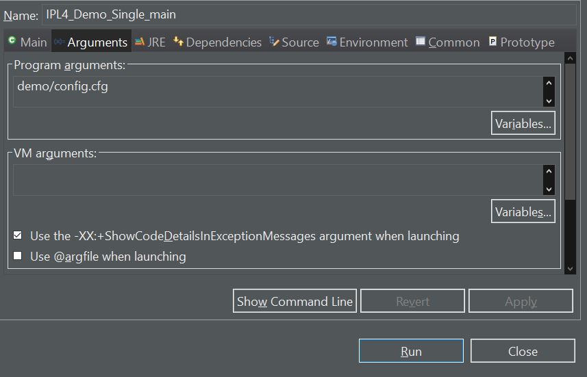

In the Arguments tab>Add config file into the Program Arguments
This is my Run Configuration Main tab:
index.php/fa/41120/0/
This is my Run Configuration Arguments tab:
index.php/fa/41121/0/
And Click Run.
