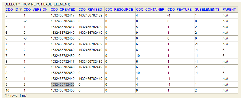

If running the test as part of the "AllTestsDBH2Audit" and inspecting the h2 database table "REPO1.BASE_ELEMENT" at the end of the test, I note the following for the "child1" element (the same goes for "child2") :
  • Version 1: The "container" value is set (to CDO_ID=6). The "parent" is not set (remains "null").
  • Version 2: The "parent" is now set to the same value as "container" (to CDO_ID=6).
  • Version 3: The "container" has changed (to CDO_ID=10), but "parent" wrongly still refers to element (CDO_ID=6). That is deleted/detached by now!
This leaves me confused on how CDO manages the db mapping of EMF container reference values. Shouldn't "parent" have the same value as "cdo_container" in all three versions described above? (Please also see the attached screenshot of the h2 db table for more clarity).
