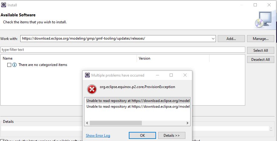

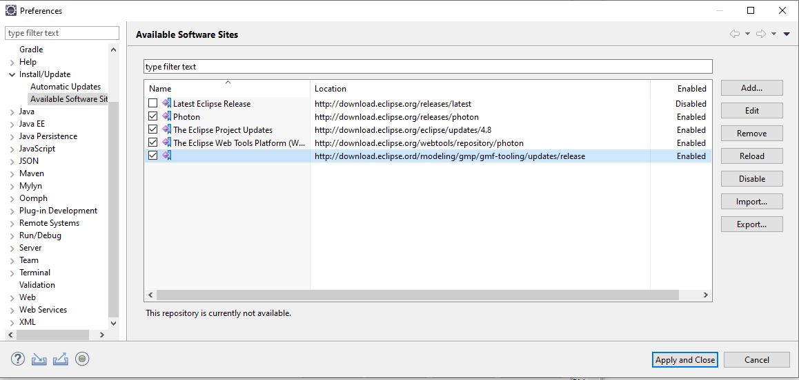

I'm trying to install a plugin and keep getting the error listed below, this was working the other day but for some reason today it's failing. I couldn't find anything online that helped resolve the issue. Under the install software windows> manager says this repository is currently not available.
Unable to read repository at
http:// download. eclipse.ord/ modeling/gmp/ gmf-tooling/updates/release/ content.xml.
Unable to read repository at http:// download. eclipse.ord/modeling/gmp/gmf-tooling/updates/release/content.xml.
download.eclipse.ord:80 failed to respond
Exception Stack Trace:
org.apache.http.NoHttpResponseException: download.eclipse.ord:80 failed to respond
at org.apache.http.impl.conn.DefaultHttpResponseParser.parseHead(DefaultHttpResponseParser.java:143)
at org.apache.http.impl.conn.DefaultHttpResponseParser.parseHead(DefaultHttpResponseParser.java:57)
at org.apache.http.impl.io.AbstractMessageParser.parse(AbstractMessageParser.java:259)
at org.apache.http.impl.AbstractHttpClientConnection.receiveResponseHeader(AbstractHttpClientConnection.java:281)
at org.apache.http.impl.conn.DefaultClientConnection.receiveResponseHeader(DefaultClientConnection.java:259)
at org.apache.http.impl.conn.ManagedClientConnectionImpl.receiveResponseHeader(ManagedClientConnectionImpl.java:209)
at org.apache.http.protocol.HttpRequestExecutor.doReceiveResponse(HttpRequestExecutor.java:273)
at org.apache.http.protocol.HttpRequestExecutor.execute(HttpRequestExecutor.java:125)
at org.apache.http.impl.client.DefaultRequestDirector.tryExecute(DefaultRequestDirector.java:686)
at org.apache.http.impl.client.DefaultRequestDirector.execute(DefaultRequestDirector.java:488)
at org.apache.http.impl.client.AbstractHttpClient.doExecute(AbstractHttpClient.java:884)
at org.apache.http.impl.client.CloseableHttpClient.execute(CloseableHttpClient.java:82)
at org.eclipse.ecf.provider.filetransfer.httpclient4.HttpClientFileSystemBrowser.runRequest(HttpClientFileSystemBrowser.java:263)
at org.eclipse.ecf.provider.filetransfer.browse.AbstractFileSystemBrowser$DirectoryJob.run(AbstractFileSystemBrowser.java:69)
at org.eclipse.core.internal.jobs.Worker.run(Worker.java:60)
Session Data:
clipse.buildId=4.8.0.I20180611-0500
java.version=1.8.0_301
BootLoader constants: OS=win32, ARCH=x86_64, WS=win32, NL=en_US
Framework arguments: -product org.eclipse.epp.package.jee.product
Command-line arguments: -os win32 -ws win32 -arch x86_64 -product org.eclipse.epp.package.jee.product
  • Attachment: Capture.JPG
    (Size: 89.95KB, Downloaded 374 times)
Re: Error: Unable to read repository at.... [message #1844539 is a reply to message #1844525] Thu, 16 September 2021 03:50 Go to previous messageGo to next message
I have never used gmf-tooling, but the URL of the update site mentioned in the error doesn't seem correct. I suggest you to install gmf-tooling using the url of one of the updates listed on download.eclipse.org: https://download.eclipse.org/modeling/gmp/gmf-tooling/updates/
You can go to Help > Install New Software in your Eclipse IDE, don't forget to update the incorrect URL in your Install/Updates preferences.
Glenn
Re: Error: Unable to read repository at.... [message #1844546 is a reply to message #1844539] Thu, 16 September 2021 07:45 Go to previous messageGo to next message
Indeed. I very much doubt that "download. eclipse.ord" ever worked; at least not as an official Eclipse mirror.
There are a number of other gratuitous spaces that suggest that the URL was manually typed. Much better to cut and paste.
Ed Willink

Thanks for the replies, I wanted to clarify a couple of things. when I created my original post I did have a unintentional typo that Ed pointed out 'download. eclipse.ord'. I added the spaces in the URL address because I was restricted in sharing links since I'm new. I hoped the community might solve that little puzzle:-).
http://download.eclipse.org/modeling/gmp/gmf-tooling/updates/releases/
the link above was my original URL I used which did work 2 days ago, but starting yesterday it stopped working and began erroring out.

Re: Error: Unable to read repository at.... [message #1844577 is a reply to message #1844575] Thu, 16 September 2021 14:57 Go to previous messageGo to next message
In my browser the link takes me to a page where I'm instructed to enter the URL in eclipse with a screenshot, not sure if this is the 404 you are referring to. Clicking the 3 ... I selected release for 3.2.1 to test and same error.
https://download.eclipse.org/modeling/gmp/gmf-tooling/updates/releases-3.2.1/
Unable to read repository at https://download.eclipse.org/modeling/gmp/gmf-tooling/updates/releases-3.2.1/content.xml.
sun.security.validator.ValidatorException: PKIX path building failed: sun.security.provider.certpath.SunCertPathBuilderException: unable to find valid certification path to requested target
Even Details
Plug-in: org.eclipse.equinox.p2.ui
Message: Unable to read repository at https://download.eclipse.org/modeling/gmp/gmf-tooling/updates/releases-3.2.1/content.xml.
org.eclipse.equinox.p2.core.ProvisionException: Unable to read repository at https://download.eclipse.org/modeling/gmp/gmf-tooling/updates/releases-3.2.1/content.xml.
at org.eclipse.equinox.internal.p2.repository.CacheManager.createCache(CacheManager.java:243)
at org.eclipse.equinox.internal.p2.metadata.repository.SimpleMetadataRepositoryFactory.getLocalFile(SimpleMetadataRepositoryFactory.java:66)
at org.eclipse.equinox.internal.p2.metadata.repository.SimpleMetadataRepositoryFactory.load(SimpleMetadataRepositoryFactory.java:86)
at org.eclipse.equinox.internal.p2.metadata.repository.MetadataRepositoryManager.factoryLoad(MetadataRepositoryManager.java:60)
at org.eclipse.equinox.internal.p2.repository.helpers.AbstractRepositoryManager.loadRepository(AbstractRepositoryManager.java:767)
at org.eclipse.equinox.internal.p2.repository.helpers.AbstractRepositoryManager.loadRepository(AbstractRepositoryManager.java:668)
at org.eclipse.equinox.internal.p2.metadata.repository.MetadataRepositoryManager.loadRepository(MetadataRepositoryManager.java:107)
at org.eclipse.equinox.internal.p2.metadata.repository.MetadataRepositoryManager.loadRepository(MetadataRepositoryManager.java:102)
at org.eclipse.equinox.p2.ui.ProvisioningUI.loadMetadataRepository(ProvisioningUI.java:444)
at org.eclipse.equinox.internal.p2.ui.model.MetadataRepositoryElement.getMetadataRepository(MetadataRepositoryElement.java:133)
at org.eclipse.equinox.internal.p2.ui.model.MetadataRepositoryElement.getRepository(MetadataRepositoryElement.java:122)
at org.eclipse.equinox.internal.p2.ui.model.MetadataRepositoryElement.getQueryable(MetadataRepositoryElement.java:115)
at org.eclipse.equinox.internal.p2.ui.QueryProvider.getQueryDescriptor(QueryProvider.java:90)
at org.eclipse.equinox.internal.p2.ui.model.QueriedElement.fetchChildren(QueriedElement.java:103)
at org.eclipse.equinox.internal.p2.ui.model.MetadataRepositoryElement.fetchChildren(MetadataRepositoryElement.java:79)
at org.eclipse.equinox.internal.p2.ui.model.RemoteQueriedElement.fetchDeferredChildren(RemoteQueriedElement.java:35)
at org.eclipse.ui.progress.DeferredTreeContentManager$1.run(DeferredTreeContentManager.java:232)
Caused by: javax.net.ssl.SSLHandshakeException: sun.security.validator.ValidatorException: PKIX path building failed: sun.security.provider.certpath.SunCertPathBuilderException: unable to find valid certification path to requested target
at sun.security.ssl.Alert.createSSLException(Unknown Source)
at sun.security.ssl.TransportContext.fatal(Unknown Source)
at sun.security.ssl.CertificateMessage$T12CertificateConsumer.checkServerCerts(Unknown Source)
at sun.security.ssl.CertificateMessage$T12CertificateConsumer.onCertificate(Unknown Source)
at sun.security.ssl.CertificateMessage$T12CertificateConsumer.consume(Unknown Source)
at sun.security.ssl.SSLHandshake.consume(Unknown Source)
at sun.security.ssl.HandshakeContext.dispatch(Unknown Source)
at sun.security.ssl.TransportContext.dispatch(Unknown Source)
at sun.security.ssl.SSLTransport.decode(Unknown Source)
at sun.security.ssl.SSLSocketImpl.decode(Unknown Source)
at sun.security.ssl.SSLSocketImpl.readHandshakeRecord(Unknown Source)
at sun.security.ssl.SSLSocketImpl.startHandshake(Unknown Source)
at org.apache.http.conn.ssl.SSLSocketFactory.connectSocket(SSLSocketFactory.java:553)
at org.eclipse.ecf.provider.filetransfer.httpclient4.SNIAwareHttpClient$1.connectSocket(SNIAwareHttpClient.java:64)
at org.apache.http.conn.ssl.SSLSocketFactory.connectSocket(SSLSocketFactory.java:412)
at org.apache.http.impl.conn.DefaultClientConnectionOperator.openConnection(DefaultClientConnectionOperator.java:179)
at org.apache.http.impl.conn.ManagedClientConnectionImpl.open(ManagedClientConnectionImpl.java:328)
at org.apache.http.impl.client.DefaultRequestDirector.tryConnect(DefaultRequestDirector.java:612)
at org.apache.http.impl.client.DefaultRequestDirector.execute(DefaultRequestDirector.java:447)
... 1 more
Caused by: sun.security.validator.ValidatorException: PKIX path building failed: sun.security.provider.certpath.SunCertPathBuilderException: unable to find valid certification path to requested target
at sun.security.validator.PKIXValidator.doBuild(Unknown Source)
at sun.security.validator.PKIXValidator.engineValidate(Unknown Source)
at sun.security.validator.Validator.validate(Unknown Source)
at sun.security.ssl.X509TrustManagerImpl.validate(Unknown Source)
at sun.security.ssl.X509TrustManagerImpl.checkTrusted(Unknown Source)
at sun.security.ssl.X509TrustManagerImpl.checkServerTrusted(Unknown Source)
... 24 more
Caused by: sun.security.provider.certpath.SunCertPathBuilderException: unable to find valid certification path to requested target
at sun.security.provider.certpath.SunCertPathBuilder.build(Unknown Source)
at sun.security.provider.certpath.SunCertPathBuilder.engineBuild(Unknown Source)
at java.security.cert.CertPathBuilder.build(Unknown Source)
... 30 more
eclipse.buildId=4.8.0.I20180611-0500
