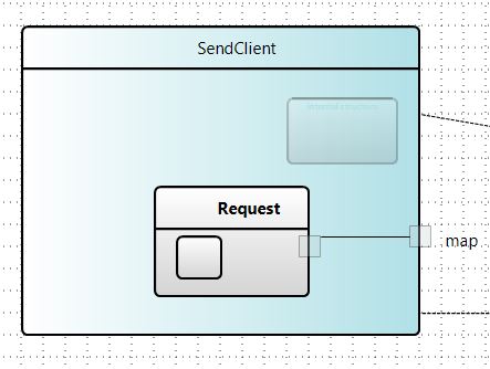

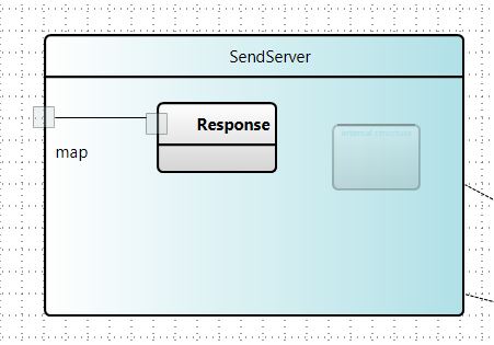

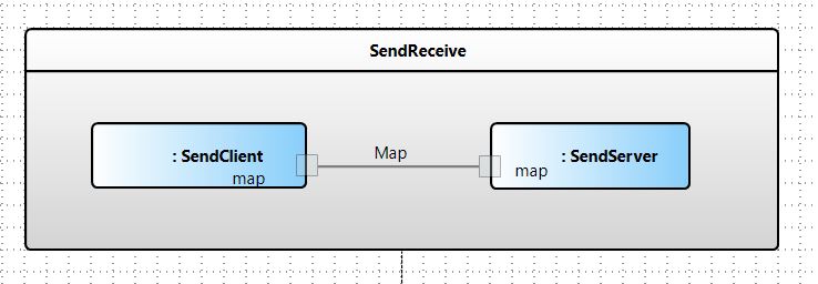

I have installed papyrus-robotics-2021-03 #726 on Ubuntu 20.04 and Windows 10, and both installations the examples are corrupt.
index.php/fa/40953/0/
index.php/fa/40954/0/
index.php/fa/40955/0/
Could you confirm when papyrus-robotics version 0.9 or a new update will be released?
Thank you in advance.
Luis.

Dear Luis,
thanks for pointing this out. I confirm that the examples in the nightly builds have an issue. As my local installation works fine, it must be related to uncommitted changes. It will be corrected as soon as possible.
Ansgar
Re: Fail - papyrus-robotics-2021-03 #726 [message #1844763 is a reply to message #1844734] Fri, 24 September 2021 04:33 Go to previous messageGo to next message
Dear Luis,
only the RCPs are concerned. The problem is related to the display of SVG images in general, see error message below. Apparently, several basic plugins (that should normally present as part of orbit) are missing in the RCP. At least the plugins org.apache.xerces, org.apache.xml.resolve and rg.eclipse.xsd are concerned. As a workaround, you can download the missing plugins from [1] and put these in the plugins folder. Alternatively, take an existing Eclipse 2021-03 build and install Papyrus for Robotics via the update site [2].
I have created bug 576244 (https://bugs.eclipse.org/bugs/show_bug.cgi?id=576244)
[1] https://download.eclipse.org/releases/2021-03/202103171000/plugins/
[2] https://ci.eclipse.org/papyrus/view/Robotics/job/papyrus-robotics-2021-03/lastSuccessfulBuild/artifact/releng/org.eclipse.papyrus.robotics.p2/target/repository/

Hi Ansgar,
Thanks for your answer.
I have updated Papyrus for Robotics(2021-03 #742) and now I can see SVG images.
However, the examples do not work correctly with the code generated in C ++ (I have reported a new bug, please check).
