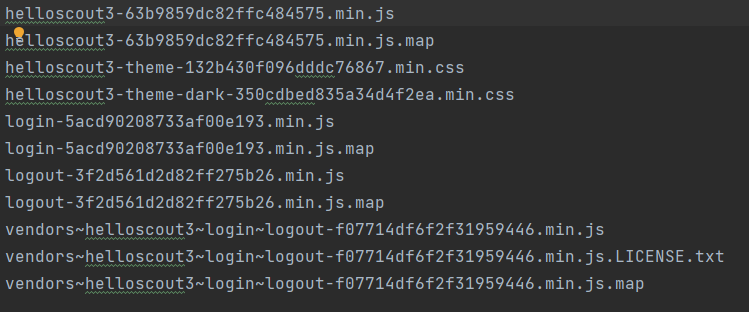

I created a new Project in Intelij with the newest Scout plugin. But when i change the devMode to false, and build and start the application i get an Error 404 on the login.html.
But as far as I can see it, everything is as it should be.
Can someone help?
The first screenshot is from the target folder, the second one is from the file-list
Scout-Version: 11
Plugin-Version: 11.0.0.2109061514

Its a feature of the devMode that the files are automatically built (via npm/webpack watchers) and read from the filesystem. In live mode file loading works differently. Files are expected to be on the classpath. Testing live mode on your dev machine is possible, but requires to run the build manually and copy the files to the right place.

In dev mode Scout loads web assets (html, js, css) from the output of the javascript dev build (npm script "build:dev"). This is the same when using the js watcher (npm script "build:dev:watch"). The output directory in these cases is "target/dist/dev" below your npm module.
If you change devMode to false Scout will no longer load web assets from the dev output but from the prod output instead. The directory is "target/dist/prod". So maybe there is no content in this directory?
If this is the case you might need to launch the production javascript build (npm script "build:prod"). This build creates prod output which should then be found by Scout having devMode=false.

I didnt know that i had to move the files to target/classes folder. I thought that building with the pnpm run buil:prod would be enough.
